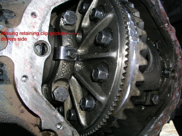

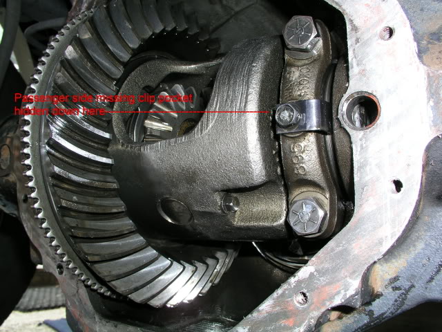

Just dug these out from an old set of files tucked away on my PC Tim.
A picture speaks a thousand words an all that bud.
This is my actual diff and LSD mate with the clips now removed. But it shows you where to look for them,
Al.

Very nice Al, thanks. So there are only two (2) that I ned to get out? Thought I saw previously there were four (4). I just took the cover off before heading to parts store for more oil to let it drain.
I guess I need to put the truck on jack stands and rotate the wheels, because now I can't see any of them or at least the one shown in my OP pics and yours. The one on passenger side, how the heck do I get to that one. Also, if they are not broken...what I can do to get them out....
Also on the drivers side far left, would I see it in that pocket...cuz I don't see anything at the moment.

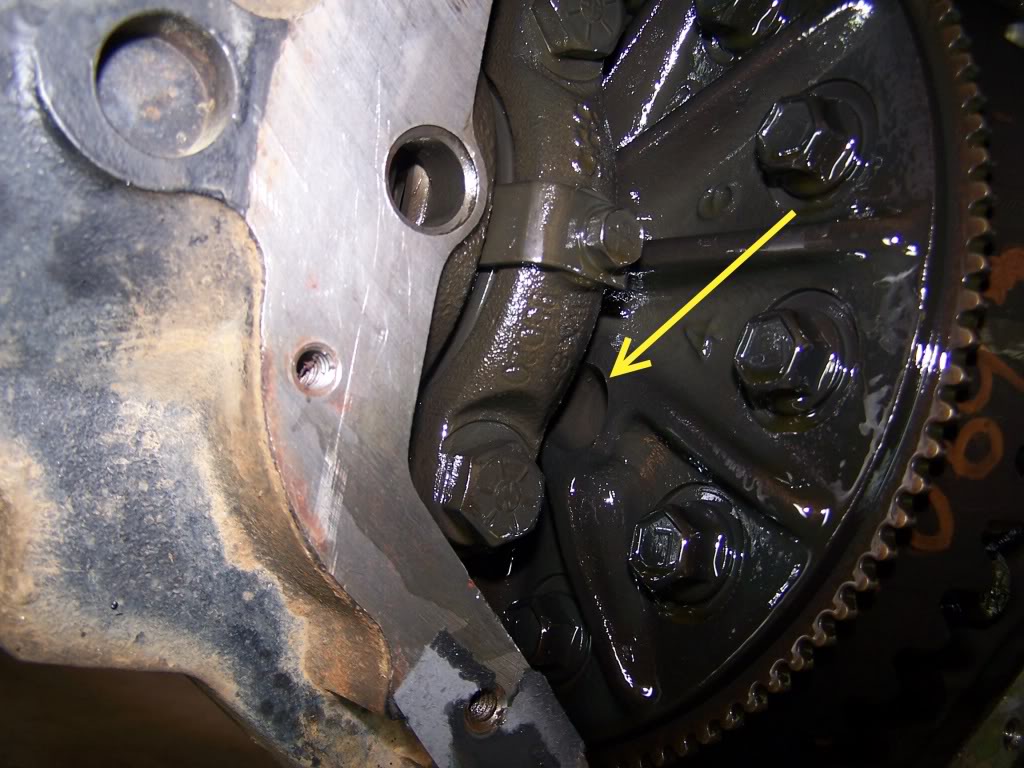

Here's a pic of the driver side, looks like yours. I don't see anything to remove?
The passenger side, I can now see one of the clips that isn't broken. Still has the "W" end on it. I grabbed it with needle nose, it's not budging. So, I am assuming that it's intact.

No there are 4 I believe.
One set of two on the left side spider gear assy and one set on the right side spider gear assy.
I turned the wheels round till I could see them and pull them out.
As I say, I think it helps if the ends of the clips have snapped off. This gives room to pull them out. If they're not damaged, leave them in but get a DTT or Aurburn in there asap.
