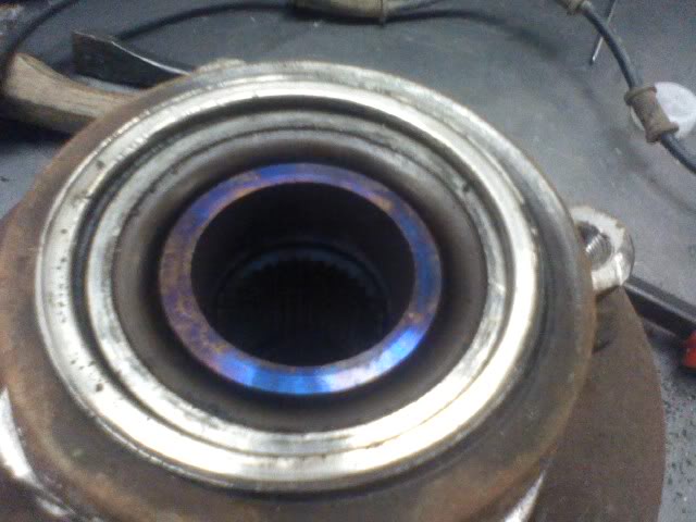

Before I get bitched at this was not my fault. This morning driving to school the truck started grinding hard from the left front. I knew it I knew exactly what was up front wheel bearing. I make it to school just fine have a nice day then try to limp it out to dads shop. Of course she is grinding but no chirping. Soon enough the ABS light comes on and she is squealing like a ***** you just dropped your crack pipe on. Pull over and yeah she is pooched.

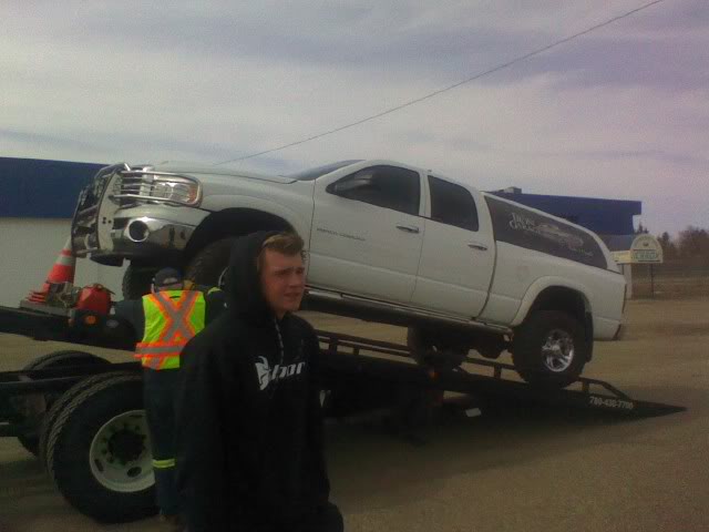

Had to use a deck truck apparently a tow truck with dollys cannot go wide enough to fit the tires lol.

Think blue ***** suck? Blue bearings are worse. This thing even when of the truck stunk like big foots dick. While I was in there I replaced both sides due to the high mileage of the truck. Bearings were 400 CAD per side. 2.5 hours to do both.

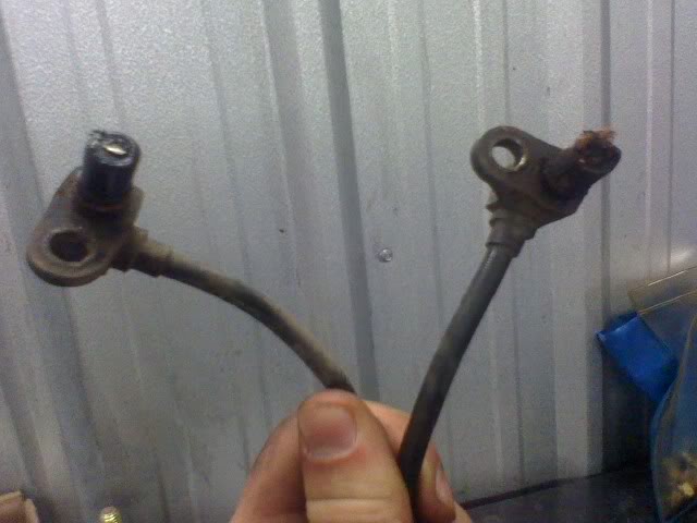

Can you tell which one is destroyed. The new bearings came with new ABS sensors. No lights all functional. ***** yeah.
