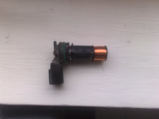

is there manny type diff-sensor that is used?
mine look like this:
my car is a 2002 1500 ram 5.9 gas
All the sensors I can find is a totally different sensor! all plastic and a bracket with a hole to fasten the sensor.
do anyone know the part # on the one I have (pic)?
