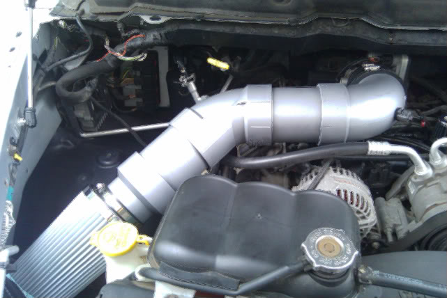

i used 4in with a 90 and a 45. so far i like it.

Used 3" pipe and made my own shield with stainless sheet metal, i am going to shave some metal off the botom the shield and get a 6 inch 3" pvc pipe and move it down to be a true cold air intake

I wonder just how effective going with 4" pipe actually is? I know with an exhaust if you go too big on the pipe, you actually lose air flow. I know with the Hemi, 2 3/4 and 3" pipe is great, but you gradually start to actually lose performance at 3.5" and larger.
Think of it as water, you get more pressure and hence better flow through a thinner pipe than through one that is too wide. Of course there is just too thin too. I think with any thing else, there is a balancing act here.

Hammer i was worried a little too going with such a large pipe, but so far its great, seems smoother and sucks some d*mn air. i will test mpg's when i fill up.

yeah CJ, I wasn't trying to criticize your setup, it actually looks KILLER! I was just kinda thinking aloud in the open forum. But I would love to be able to pull some CFM numbers and find that pipe size that is "just right"...
