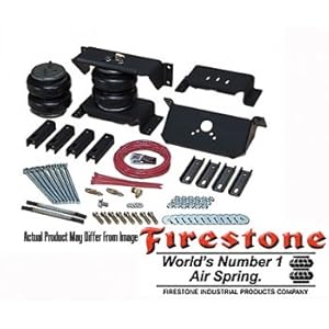

I used Arnott bags. They ran $225 shipped off ebay and were bolt-on only, no drill or welding.
The pic from above looks like they require bolting that requires drilling??? They look identical to the Hellwig bags which are a direct knock-off of the Arnott bags I have.
I would say your a bit light on your load, but the bags will eliminate ANY sag whatsoever. Unless you hook up to a trailer regularly or have more than 400lbs in your bed regularly, the you don't really need the bags IMO.
AF, Firestone, Hellwig and the Arnott bags that mount over the axle rather than the leaf spring can still be used on a lifted truck. There are spacers that you can buy to match your lift and allow your bags to be raised up accordingly. You block your leafs and block your bags the same. Just an FYI...
