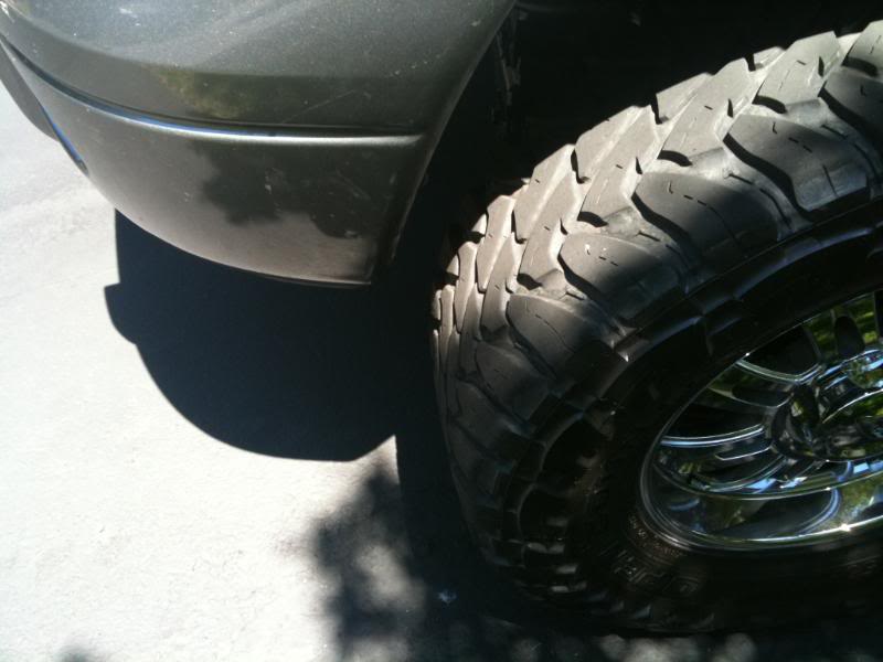

Here a couple pics

First of all, I think the previous owner had more done than just the Fabtech kit, 37s won't clear with just a Fabtech suspension lift alone on a 1500.
Secondly, you may not find the answer because I don't believe "hundreds" are running that setup. Most will heed the warnings and NOT run 37s on an IFS truck.
Could be the weight is contributing factor to your issue, 37s are HEAVY, 20" wheels are HEAVY, so the combo ain't treating the front end too well.
I'd take it to the dealer and make them make it right for sure, you just bought it, it's their responsibility to make sure it works right, with NO warning lights, when you take possession.
But I'd seriously consider dropping down to 35" tires and personally, I'd be looking at 17" wheels. 20s are pretty much useless on a 4x4 anyway, unless you are just into the "look" and don't go off road.
Your CV shafts, tie rods, ball joints, etc. will thank you. Front end repairs and maintenance will probably cost you more over the long haul than the price of tires, especially if you can sell yours to a guy with a SFA truck...
