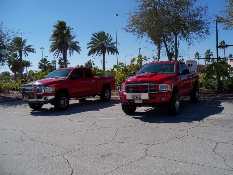

I know, I still say those Swampers look puny compared to your old Mud Grapps. I was parked next to a lifted '02 Ram 4x4 at the golf course the other day with 35" Super Swampers and the tires looked a good two inches smaller and narrower than my 35" FCIIs. And I always b*tched that my 35" FCIIs only measure 34 1/4"!!!
Somebody needs to send Interco a tape measure...
and to the OP: I would NOT base tire fitment on your 4x2 off of guys with a 4x4. Pyro has a 4x2 with a 6" lift and I have a 4x4 with a 4" lift and my truck sits a good 2-3" higher than his. Granted I have 35s and he has 33s, but measuring my tire diameter vs. his, mine are barely an inch bigger. So there is DEFINITELY a height difference between a 4x2 and a 4x4.

Hammer, I know you can look at some 4x2 rams and they look low as crap, but then others look the same as 4x4s. My buddy has a stock 06 4x4 and we used to park beside each other at work and even with my 1in level they were the same height
