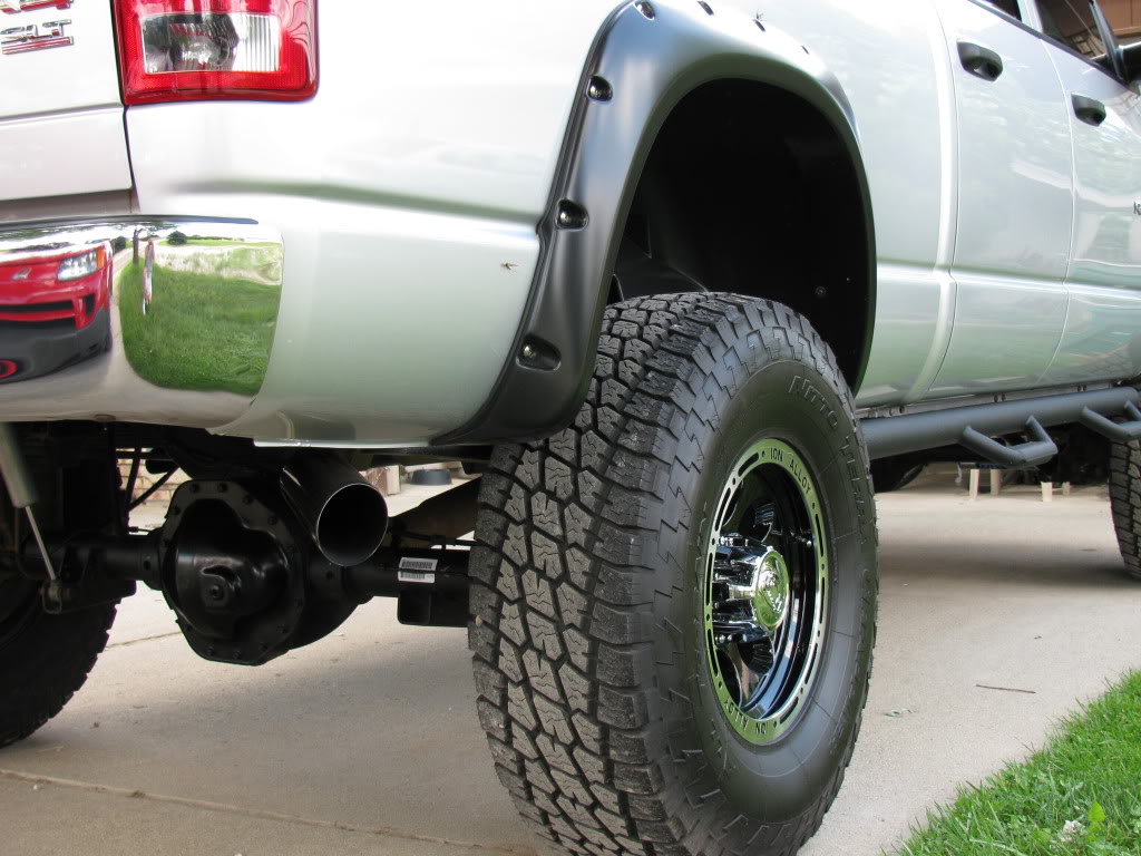

these are 37" with 5bs
here is how much mine stick out(I had to add flares)

Thanks for the response guys. Dan, the look of your truck is nice. Thanks for the pictures, really helps. That is the look I am going for. Plan to add black fender flares, black 4" oval nerf bars, chrome rocker panels to go with the new tires/wheels (truck is tan color). As I understand, no harm with -12 offest? I do like the "look" of a wider stance as long as it functions well. Thanks again.
