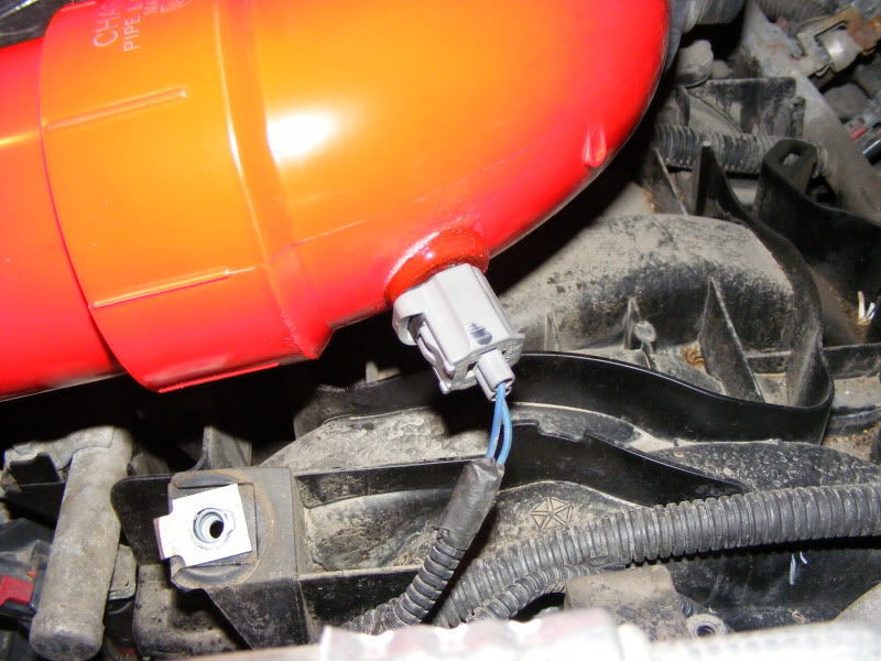

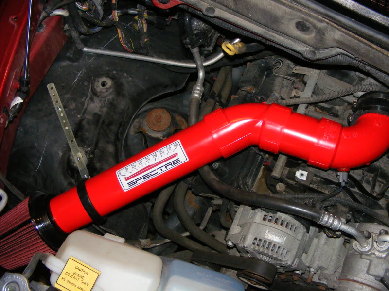

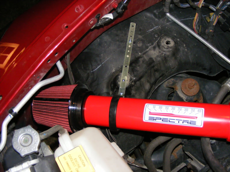

Well Its All done,Didnt think I was going to have time but did.Went with the Spectre filters.Sounds great
Also If anyone is interested The auto parts store I went to carried a Spectre Vacuum\Sensor Kits.It included the rubber gromets the sensor slides into and all kinds of adapters for different sizes and 2 different hole saw bits for a hole the rubber piece fits into perfectly.Its was only $5 for the whole kit.Part # is 8711
Here a couple phots,let me know what you think
