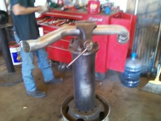

hey every one just got a cai made its out of 3in ex pipe
at the tb 3 1/2 piping is streched to 4in to fit snug over the factory rubber ring

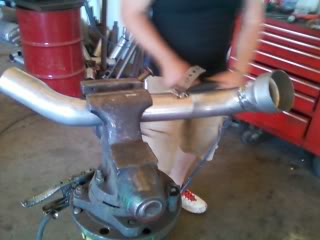

them the tb piece was mig welded to the 3 inch ex piping that we had already bent to desire.

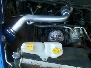

then more test fitting the piping and figuring out how to support the intake

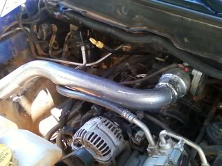

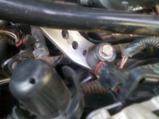

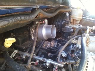

so we decided to weld a ex bracket to the intake so that we could bolt the intake to the left side manifold intake bolt spot
