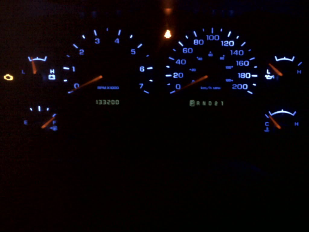

What size bulb(s) is behind the gauge cluster? I looked through the service manual and just about everything I could think of to find the bulb size. I want to run LED bulbs back there.

your bulbs for your cluster are all different. and all i can access is mopar part numbers, not bulb numbers

Bulbs i used were:
B8.5D , 11 qty for the cluster i believe the 06+ only have 5
Neo04-B, 2-3 qty in the over head, 3 if you have the extra buttons
NEO5, 2 blue 1 white Climate control (need to be trimmed a bit)
if you have remote entry you have to remove a box on the back to get to a screw to complete the install, the box pulls straight out, also have to shave the back of one led so the box will go back on
and i got them at super bright leds

Bulbs i used were:

Bulbs i used were:

Bulbs i used were:
