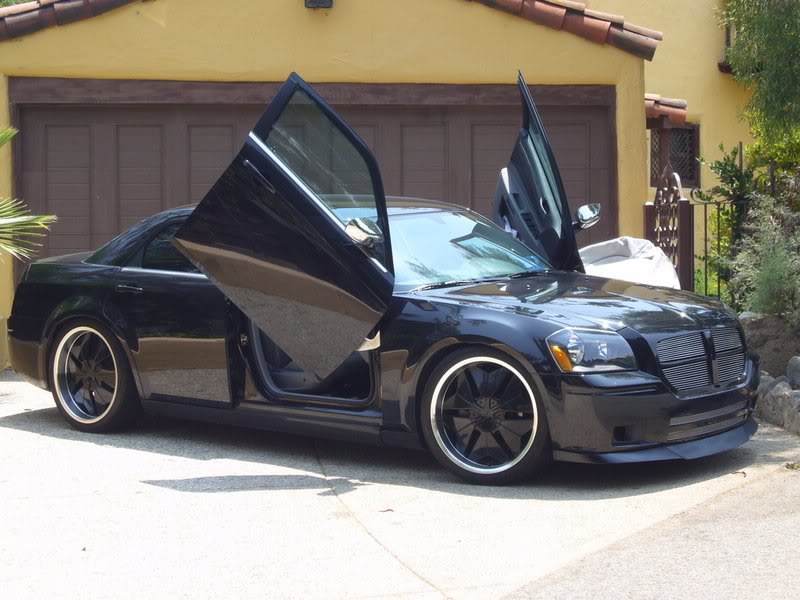

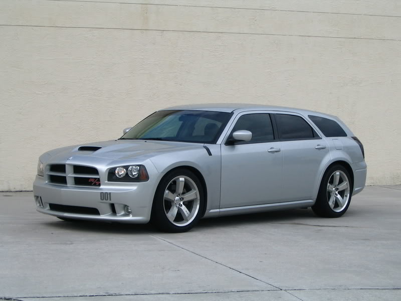

It's all the same platform (300, Charger, Magnum). I've also seen a 300 front clip put on a Magnum body to make a 300 wagon. Even the Challenger is just a modified LX (shorter wheelbase, just like they did back in '70). There's a guy on the LX Forum that has one in his avatar. I'll see if I can find it.

Here's one I found:
Old Sep 12, 2010 | 08:17 PM
HemiLonestar's Avatar
HemiLonestar
Joined: Nov 2005
Posts: 3,739
Likes: 8
From: MD

Here we go:
