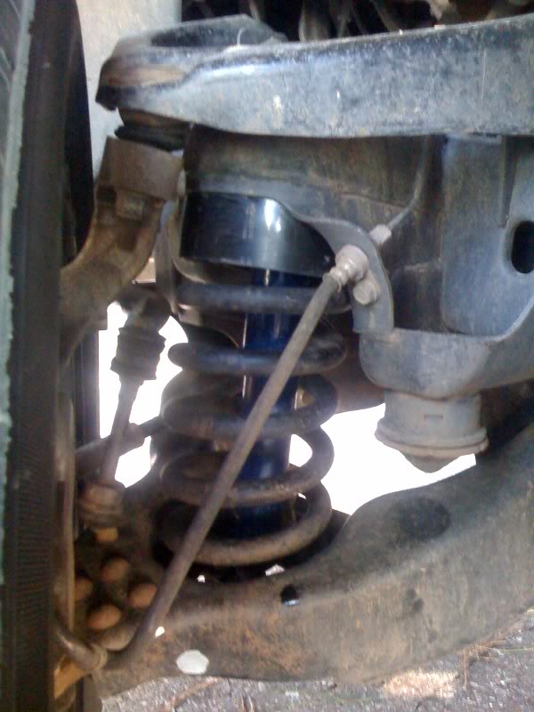

go outside and look at your suspension and you will understand what is going on...you have a spring in a bucket between two control arms, connected by a spindle, with a shock in the middle of the spring...You can either get a longer spring, a spacer for the top of the spring, or a longer spindle to lift it...
