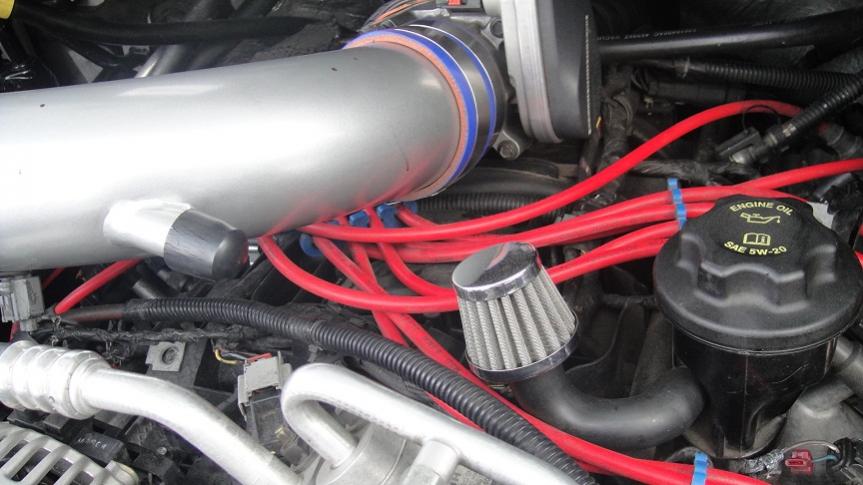

put a breather filter where the hose comes out of oil filler...I've run this way for 3 years and over 100k miles with no ill effects and my tb...and I don't have to clean it as much...
Attached Thumbnails what can i do to keep oil out of my throttle body?-breather.jpg
