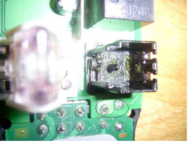

I've had the same problem on my 03 Dodge Ram for some time now. I found this write and followed the directions but it did not fix my problem. As I looked closer, I noticed that two soldered connections were broken right next to the black switch. You can also see in your pictures that your solder is also broken if you look closely at your pictures. I resoldered those two connections and all my windows work properly now. Great write up with pictures by the way.
