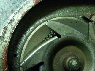

my radiator once had a leak and i tried to be cheap, so i dumped a bottle of radiator stop leak pellets and 2 months later...(yesterday) My water pump started to Sqweel really loud! i took it off and found.....
It was all chewed up.
NEVER USE THIS STUFF!!!!
it was a pain! to get the new pump back on!

Pellets, grits, black pepper, block and head sealants are all "get-by's" and not a long term fix. The same goes for Green Slime and Fix-A-Flat.

Thankfully though, the water pump is easy to change out and doesnt cost much.
