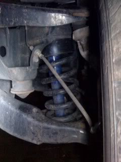

no I was talking about 2wds....
the 06-08 setups seem to have alot more problems leveling than the 05 unders...the upper control arm is a big stamped steel piece instead of the skinny one used on previous models....it hits the spring bucket even with 1.5s sometimes and nobody has a fix
also, brake lines are mounted different and are stretched taunt with a level on 06-08
