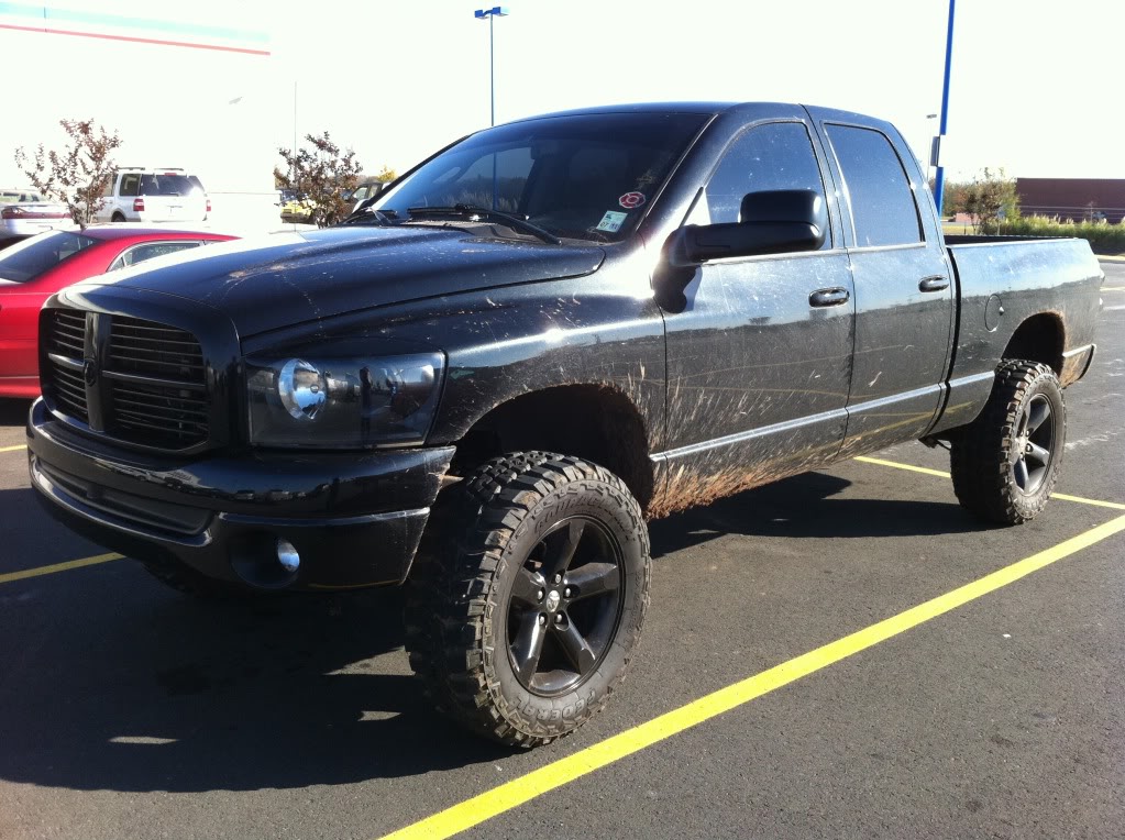

I have the same tires on stock rims. I have 1.5in hub centric wheel adapters, but cant remember where from?
motorsport tech or socal supertruck sell them or ebay

If you get 1.5in, you will not have to cut the studs. Thats really why i got 1.5in instead of 1.25in. Ive had them over 6 months, tons of towing and a bit of offroad. The spacers have studs, you dont need them. They are actually adapters meant to fit a ford on chevy, etc bolt patterns but you can buy them to do the same pattern.
