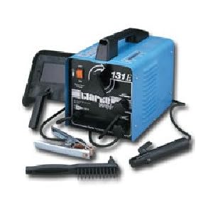

BTW, I have a small 110v 130A ARC (stick) welder that has been used three times if anybody wants it. I originally bought it because it's light and portable (for a welder anyway) and it can be used for jobs (would be great for exhaust work as it's rated for up to 1/4" steel) where I can't get a 220V line. But I got a "deal" on a $450 110V 140A MIG for under $300 soon after I bought it.
I have the MIG and a 220V ARC welder (and a gas setup for that matter) and have no need for it. Paid $229.99, I'll sell it for $125 + shipping if anybody here wants it.
I'll wait a day or two before putting it in the classified section on the forum or Craigs List so 3rd Gen guys can have first dibs.
