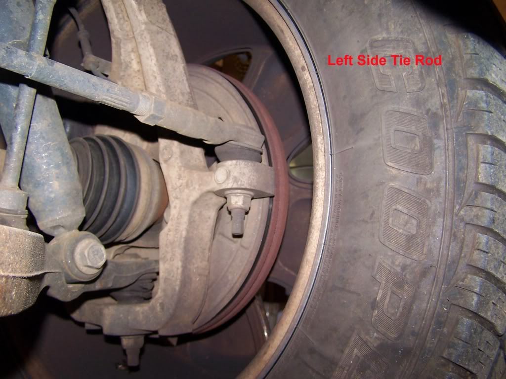

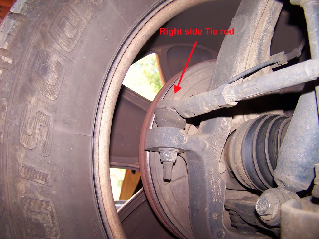

I have a few questions on this one. First, tie rod info. Here's a pic of left and right side for comparison. I've got over 190K miles. The right side looks like it's almost at a 45 degree angle where it connects. Is this a problem? Is it possibly bad?

That tie rod on the right side look ok?

Regarding your tie rod, if there is no slack in them, they look fine. If you grab that tie rod on the right side in your pic, you can twist it straight. They are supposed to move back and forth like that. Just movement from the "ball in socket" area is bad.

Thanks BD. I'll check that tie rod out. Yep, forgot all about Weed's manuals.
