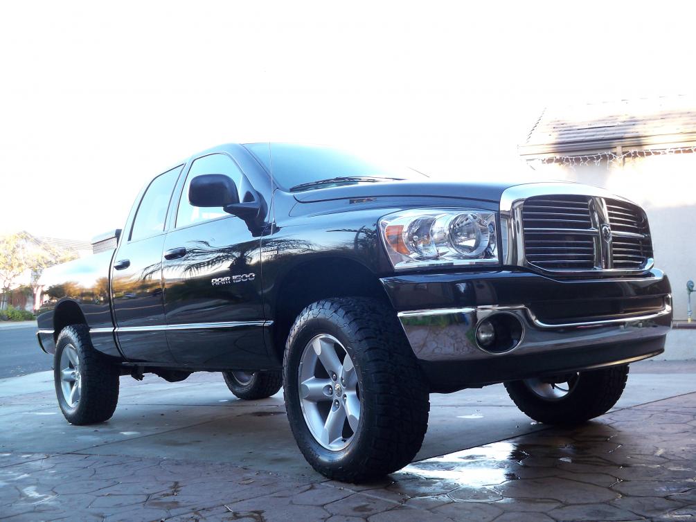

Ya thanks for all the info I'll check the exhaust manifold for leaks. other than that not one problem.except one other event I was off roading in the desert and when I went off of a 2foot wall of sand into a river wash and hit so hard that it shut the engine off.question is there a safty device that was triggerd? Oh you all have some real nice rigs.

you could have jarred a number of sensors to cause them PCM to shut down the engine. Better be careful

Hello, and yes sir your right about that. It was late in the day.I was heading west by north west and had the sun in my eyes and didn't see it untill my dog and I got the shock of a hard bounce.I had spent 3 day's and 2 night.
