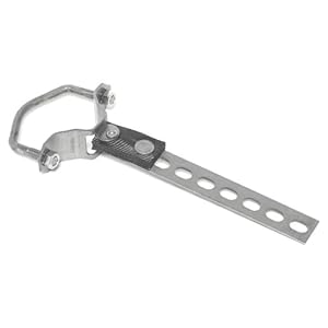

I've gotten to where I like just the simple 90* stainless hangers. All of $3 a piece at my local auto parts store and being stainless, they last forever. Just a basic tack weld on each end and you're done.
Just don't get that steel strapping crap, will start rusting out on you by the end of the weekend.
