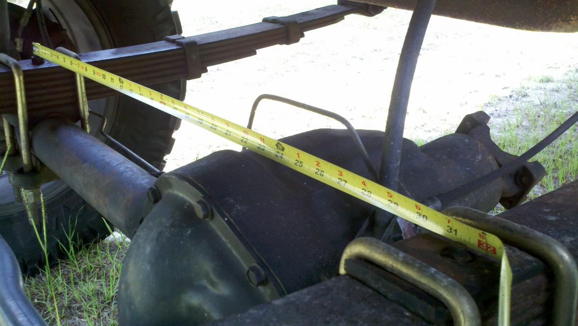

jaybuller, The Ford Dana 44 leaf sprung axle is 31 1/2" center to center. My Dodge frame up front is 33 1/2" center to center. I welded a 35 1/4" wide cross member from my frame so I could weld my spring hangers @ 31 1/2" center to center (also my stock cross member was in the way of my steering gear). Like rs182 said, "I drilled some holes, sleeved it and bolted it up." I used a 1999 Dodge ram steering box and because my truck has a body lift as well I have an adapter to go between the steering shaft and gear box. If I'm not mistaken you can bolt the shaft from your truck right to the 1999 steering gear box? I will include more pictures.
rs182, I used the 78 F250 leafs with the front end (which is a stiffer spring) and I haven't had any body roll issues. If you do have body roll then install a sway bar.

1978 Ford F250 Dana 44 w/ 78 Ford F250 leaf springs
I have no issue with body roll to speak of. I have brackets I built to install my bar again but never got around to it.
I am Surprised that you dont have excess body roll, even with stiffer springs your narrow spring location makes for a substantially larger moment than a 36 or 38 spring center.
Hell if it works for you then great!
