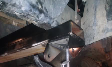

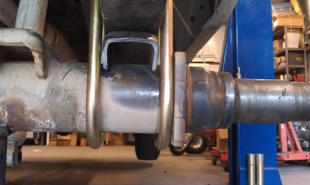

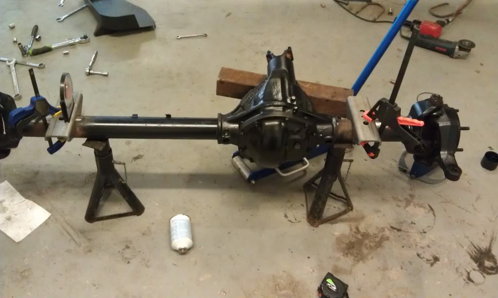

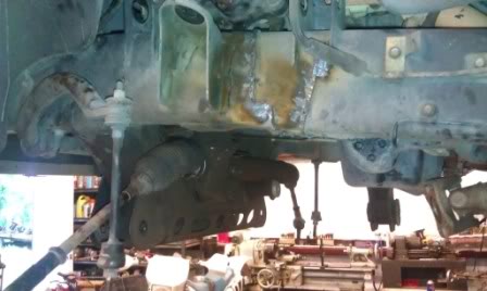

Update! Finally got around to working on the truck this weekend. I got all the Ifs crap cut off, axle prepped and fab up the new cross member and spring hanger. I did make a few minor changes as I was working.
The springs are on a 36.5 centers so I can bolt a super duty axle up later and the width works perfect for the dodge frame.
I ended up ordering a rough country 2" chevy lift I found on Ebay for $400 new shipped to my door. Came with shocks, leafs, poly bushings, 2 " blocks, and U bolts. The only thing I cant use is the rear U bolts since GM corporate 14 is 3.25" OD and the 9.25 is 3.5"OD Money well spent I hope.
I am not sure how steering will work out I may have to do cross over. Ill see how it looks after the axle is mounted.
He are a few pics of progress so far

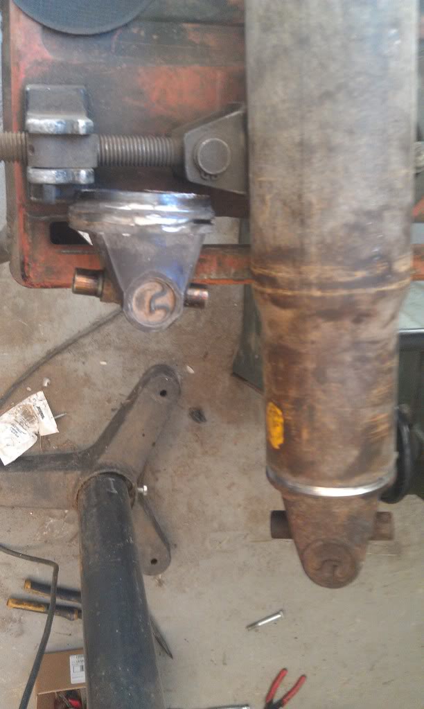

Here is the cross member/springer hanger
Test Fit
I left the factory cross member in until the replacement was welded in to insure everything stays straight.

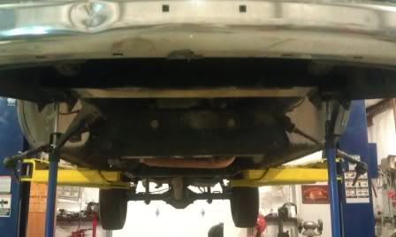

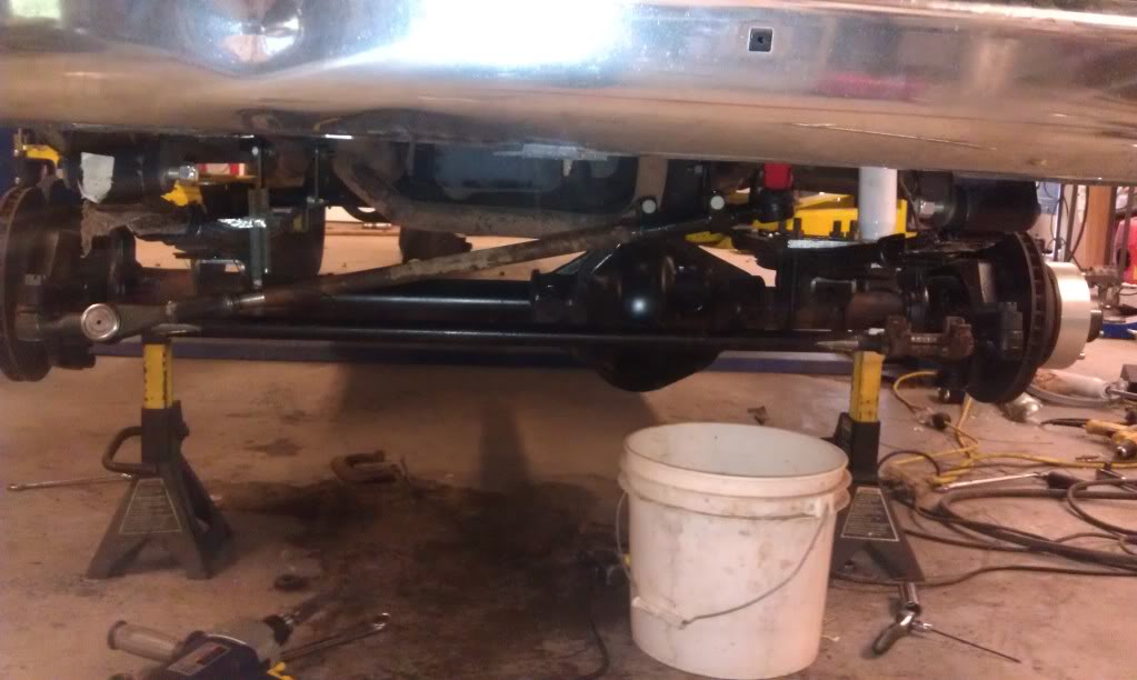

UPDATE sorry for the delay guy. I have been super busy. The truck has been running solid axle since august. It of course took about twice as much time as I thought and cost twice as much too. Projects like this seem to work out like that. Here are more pics of the SAS for your enjoyment.

Building custom steering linkage

Axle installed

On the ground

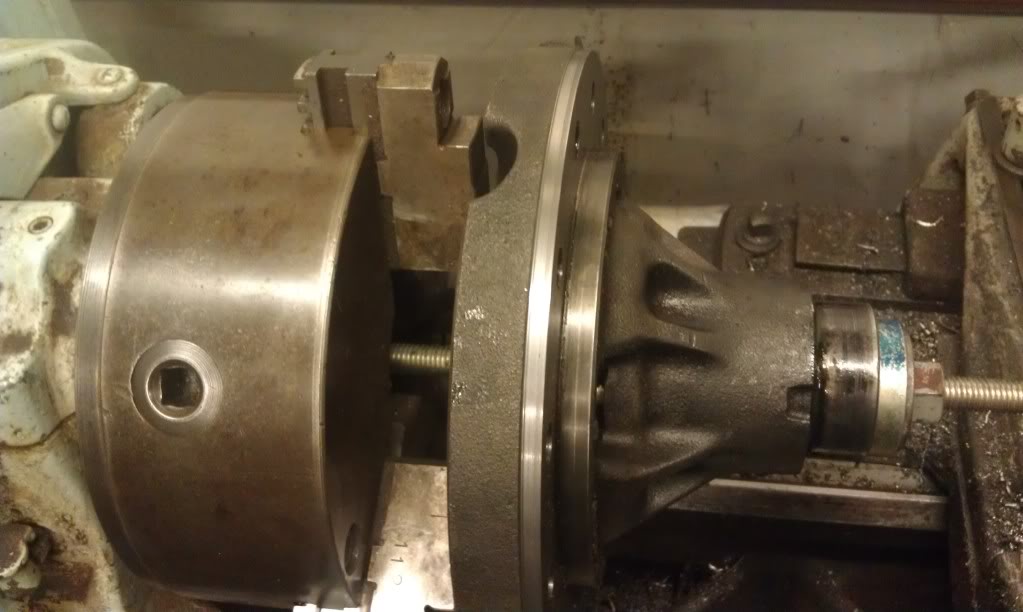

I didnt realize that the PCM used the ABS/tone ring for a VSS. I pondered for a few days and started looking at tone rings that would fit a 14bolt. Turns out a dana 70 is damn close so the truck went back on the lift and out came the carrier and on the lathe it went

soon I was in business

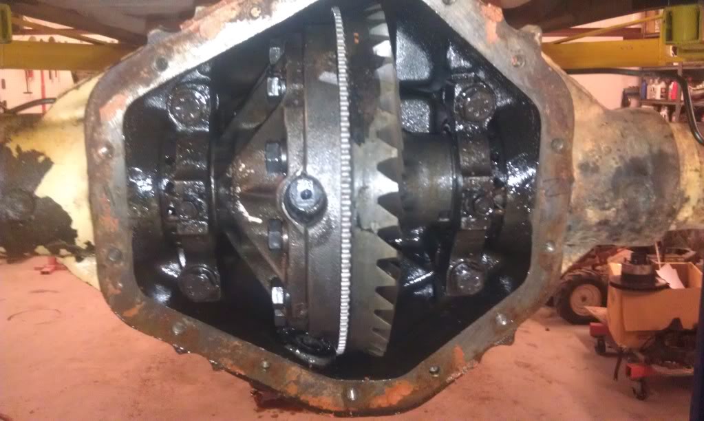

I got the carrier installed and double checked the back lash

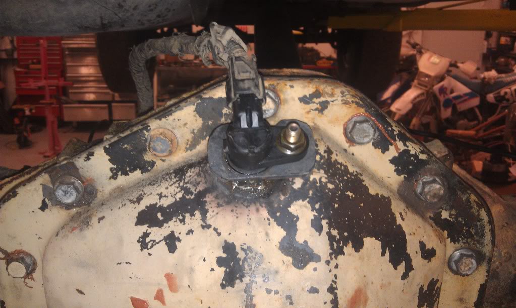

I built A mount into the diff cover to hold the sensor
