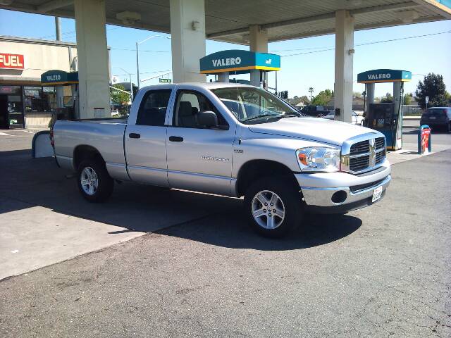

Yeah get the spindles level the truck to within a half inch. The look is the way those trucks should have off the assembly lineleveling 2wd ram 2007 help please-1302472399580.jpg
