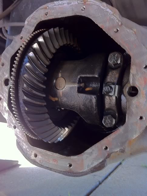

Well honestly I'm not too sure how overdue this was but I know it was. The oil came out almost black . I'm no gear guy and I have never seen these gears brand new, but to me they look pretty good still, nothing looked like it was wearing unevenly.
There was just a small bit of extremely fine metal "dust" on the magnet. But then also these were stuck at the bottom.

c-clip... it's a standard issue.. if you opened a diff after that many miles and didn't see one, it would be most certain you have an open diff.. what were those engineers thinking?

Guess you lucked out, that it didn't take some gear teeth with it. You should probably pull the rest while you're in there.

Pretty sure there is another retaining clip in there and if one broke free, the other one is a time bomb waiting to break. Reason is because the clutch packs are slightly slopping around in there now and the one cannot do anything but get worn and pounded against... I'd try and get the other one out before it cause you problems. The slop will eventually wear down the track they lie in, but with almost 200kmi, I wouldn't worry one bit. Talking after 30-50kmi
