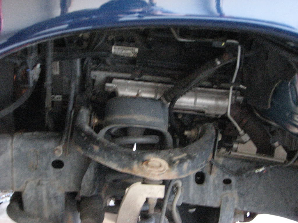

okay im new to the hemi but been doing alot of reading on this site. im apparently due for the spark plugs and was going to tackle it myself. i took off the air assembly to take a look at it and it seems like i can get almost all of them except the right hand far back ones. i know some people go through the wheel well but i dont understand why?? is it because there is better access that im not seeing for those back ones ?? any tips and tricks will be appreciated.. i got my di-elec for the tips and anti seiz for the threads oh and also p/u the gap tool too.. dont think im forgetting anything..tks in advance

Taking the wheel's and wheel well liners out is the only way to go. it is a lot easier to get to and doesnt' kill your back being bent over for hours trying to get to stuff.
Here is a pic of the access you gain through the wheel well
