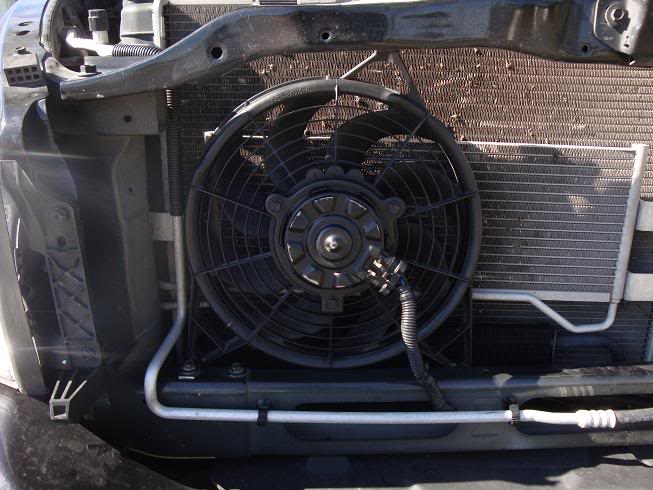

I got this 12" e fan from a 94' Ford Thunderbird SC that was used for the intercooler. When I finally figured out how to mount it, I decided to put it from of my tranny cooler and got started...
You can't see it from this angle but on the right side, I had the trim the shroud a little bit to get it to fit over the oil cooler

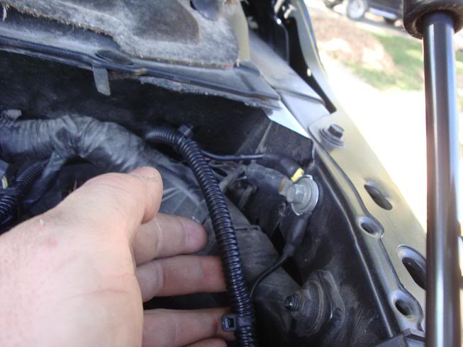

I ran the power, source and ground wire along the driver side fender

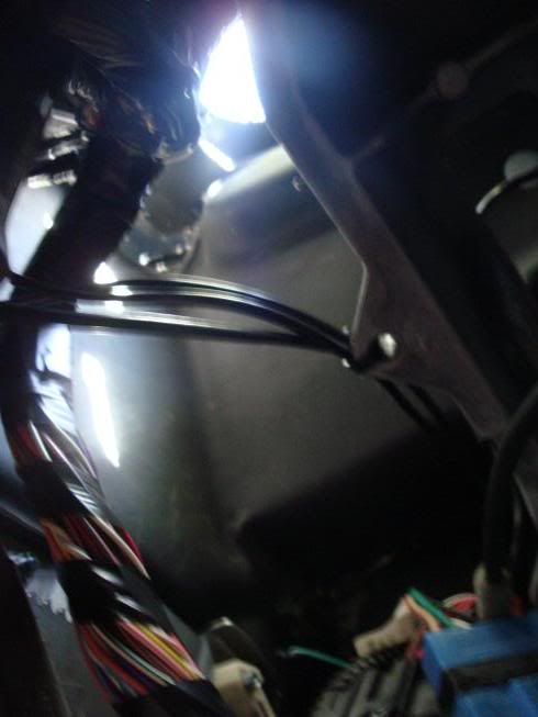

Source, power and ground wires ran through the firewall on the driver side

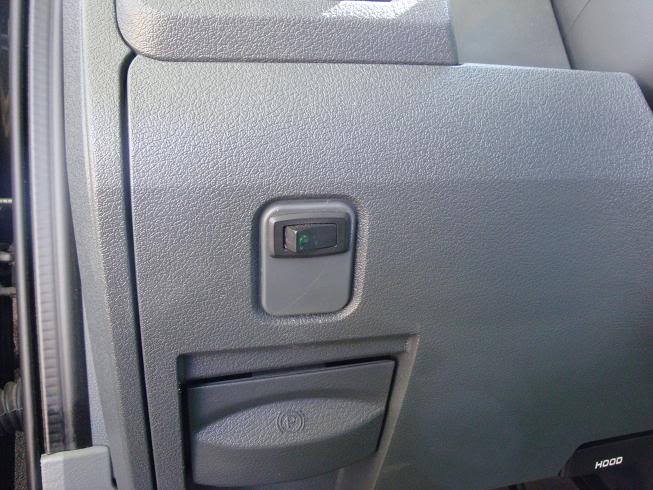

Wires ran through the firewall going to the switch
