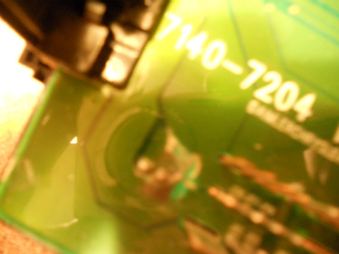

Well I think I found the problem. I spent about an half an hour taking the thing apart. Everything looks clean except for one spot. The one spot is right by the parking light relay. It looks a little corroded and the clear coat is peeling up along with part of the green board. It looks like the circuit is broken. I will try and post pictures of the board.
