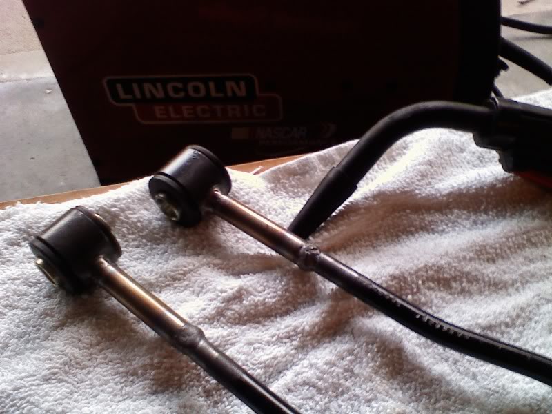

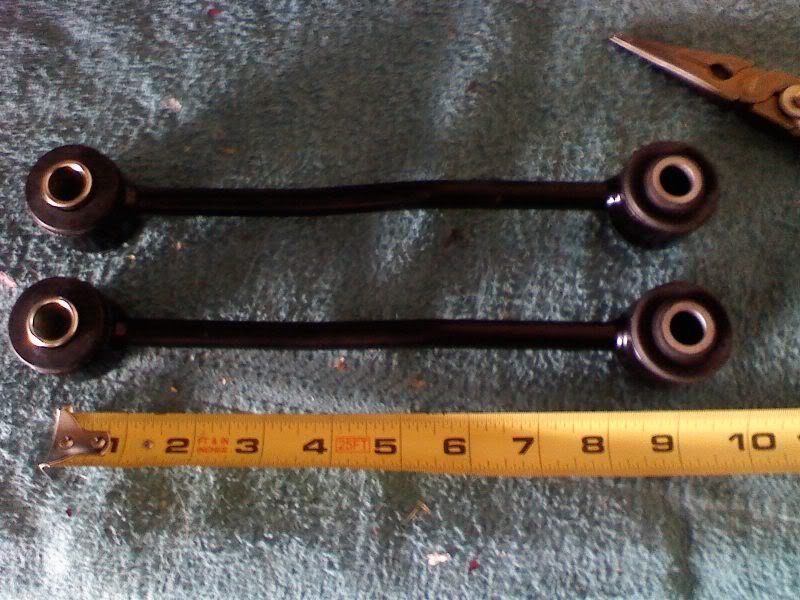

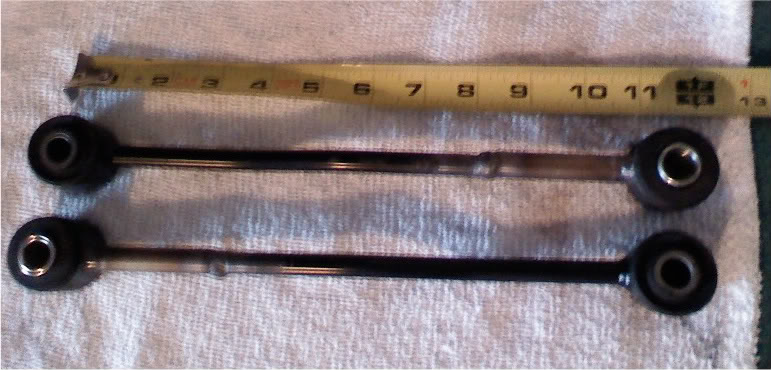

BTW, I haven't priced Ram swaybar links, but I just bought a set for my Grand Cherokee to cut and weld longer to accommodate a lift I just put on. Mopar ones were $70 each, I bought Moogs (very good brand) online for $23 each...
I wasn't about to spend $70 just to go to cutting on them, besides I'm sure the bushings on the Moogs are as good if not better.
and yes, before anybody b*tches, I painted them! They were too hot still when I snapped the pics...
