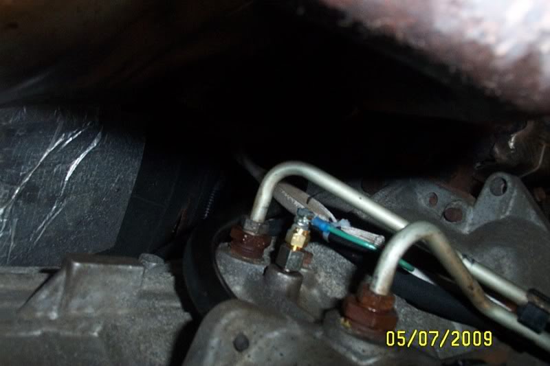

I have an 04 1500 with a Hemi. I want to put the temp sending unit in the test port of the transmission. I crawled under it tonight and there are 2 ports that are plugged off. Which one do i use?

I looked in that section. The post i found, the pics were gone and he just said use test port 3. Mine are not labeled so idk which one it is. I PM'd him, just wanted to see if anyone had an iea which one it is.

Sorry, my Grand Cherokee's radiator decided to blow up on me and I forgot all about it. Here is a pic I found in an older post in this section that shows the location...
Now I did not use the test port, I used a "T" fitting on the trans cooler out line. Either way will work fine...
