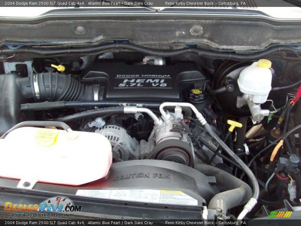

Rear manifold tb or forward tb facing upwards?

Yep If the TB is located at the rear of the manifold then you have the 1st gen 5.7L.
i.e below
If its upfront with it facing upwards then most likely you have the 2G 5.7

1st gen it is then. Thanks much, jesse
