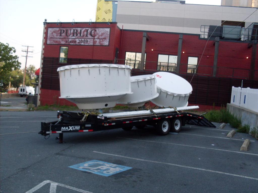

I had to do the same once, pulling a 14' flatbed tandem which weighed 8000lbs with another 3000+ lbs on it. The wheels are so far back, it made the situation even worse. That would be the same day my brake controller failed while travelling through D.C.. I also got to meet the Secret Service that day. They thought my load was a vat of brew and I was targeting the white house. Funny day.
I will never hurt my truck like that again. So I put in airbags, but will never go over weight. It is too much to manage. Scary day driving. I slid through a red light or two that day.
