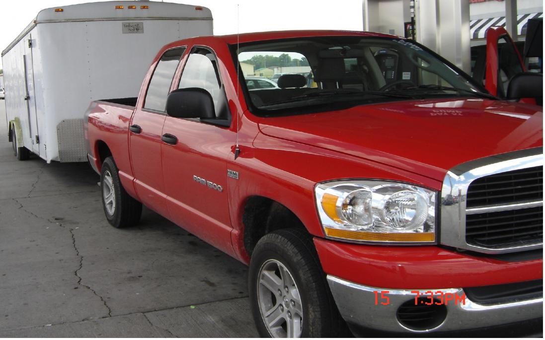

Kinda curious if something like this would work on a Hemi. I know fuel lines and all that are different between diesel and gasoline, but just a tank, and obviously prolly a sending unit needed to get that deep, seems it'd function the same, but I am just assuming...looking for actual knowledge to answer this. I am eventually going to move to Alaska and when driving up through Canada, gas stations get few and far between, so a nearly twice as big fuel tank sounds appealing
I see your point to an extent...but do you think it'd really show with this 32 ft bad boy stuffed to the brim with everything I own that is worth taking with me??

You'd need helper springs with that much added weight and handling will suck with your suspension. Plus, if your state is anything like mine....most gas stations dont allow you to pump more than $75 or $100 depending on where you go. I know Hess bumped it up to $100 reently. It's not even to prevent run-offs because i use my CC everytime and have to use a different one for that extra little bit sometimes. Sucks.
Also, clearance nay be an issue. The 2500's sit higher as well.
