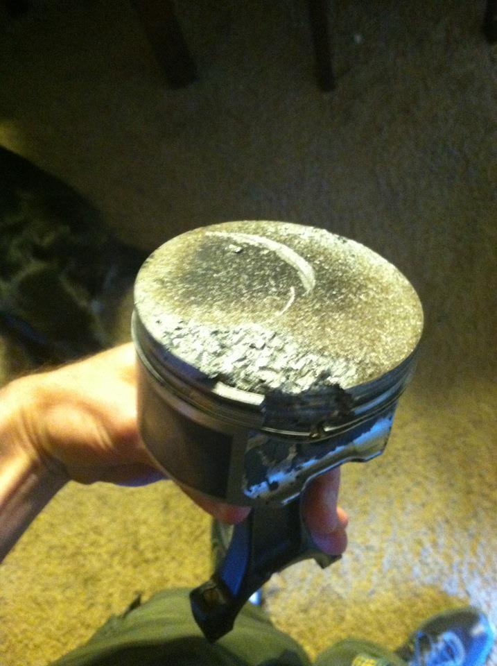

Well I got the truck back today!!! Runs like a champ.
I got really lucky the dropped valve pieces were in the intake manifold. So I was so close to messing up the other side lol

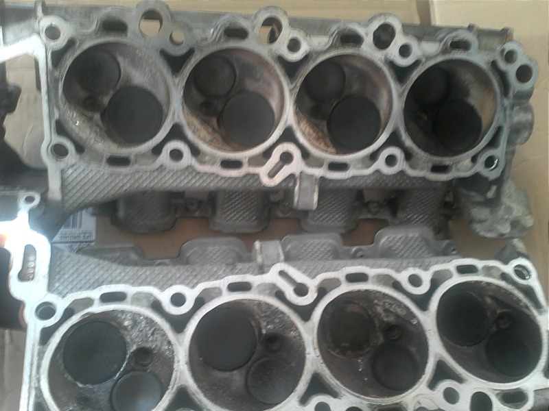

Auch mir machte es:
I hope your guy flushed the sh*t out of that manifold, brother. Was chatting with a guy today lost a valve seat in a Charger and the shop rebuilt the head, cylinder and didn't get all the crap out of the manifold. Engine didn't last 300 miles!!!
