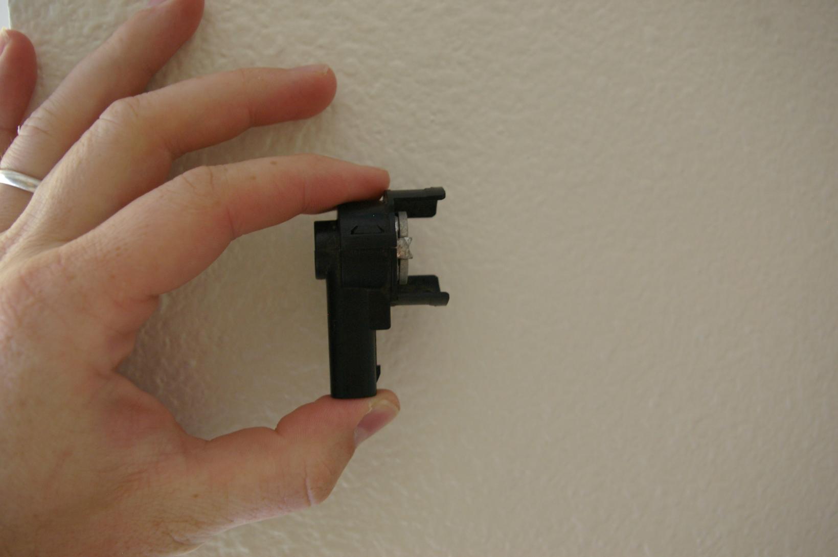

I was driving down the road and my foot was hitting something that sounded like it was an electrical arc. I stopped to take a look and I saw that this was hanging from a wire. When I turned it sideways the metal bar on the inside pushed out then receeded back inside causing this clicking sound. Everything works still. I just removed my center console to replace radio but I don't see where it could have connected anywhere that the wire would reach.

Try shifting your truck from Park to R or N without putting your foot on the brake pedal. I bet it will shift.
Looks like the one in the link?
https://dodgeforum.com/forum/3rd-gen...tify-part.html

Thanks very much. i would have never seen where it attached to. Yes it did shift without my foot on the break.
