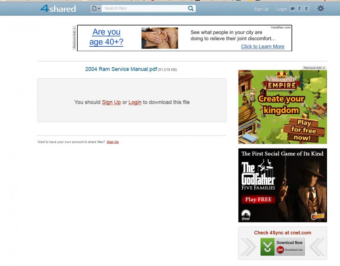

Old Jul 16, 2012 | 10:04 PM
Bent's Avatar
Bent
Joined: Feb 2010
Posts: 312
From: Pinawa, MB, CANADA
gets me the same screen...

Old Jul 16, 2012 | 10:06 PM
weedahoe's Avatar
weedahoe
Hall of Fame Member
Posts: 19,168
Likes: 23
From: South GA
Must be something new they are doing. Ive never seen it. Hate to say it but I guess you will have to sign up.
I will see if I can upload them to my SkyDrive later
