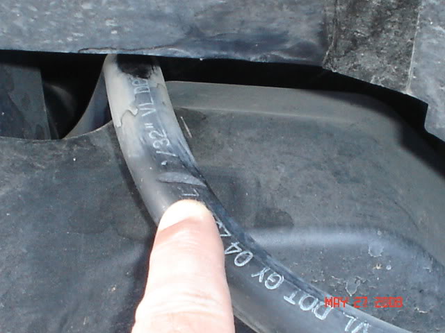

Since the cruise system is a pressurized system I'd be looking for a leak in a line or a failed clamp. Odds are it's a small leak which doesn't effect the system until pressure builds to a point (which would explain why it stops working at higher RPMs or basically around a certain speed).
I helped a girl diagnose this same issue on her truck a few years back and found a cracked hose:
Which caused the same symptoms you are experiencing. Replacing the hose fixed the problem in her case...

that sounds great I will definitly look into that...where about is that hose on that pic that you posted? so i know right where it is...man I sure hope that is it lol, it's not like I use the truck alot but it sure sucks when it does'nt work right

check the hoses first then we can track it back from there.

The cruise is computer controlled, with the hemi being fly-by-wire vacuum hoses should have no bearing on it.
Yes but the cruise computer uses inputs from the various sensors to determine load on the engine, that is why the truck downshifts for you while in cruise control when going up or down a hill... So the vacuum lines should be checked.
Next thing to check is speed and ABS sensors to make sure they are not damaged or malfunctioning.

great thanks for the replys....I will check all the vacuum lines and I'm not sure about the ABS sensors...how many are there?
