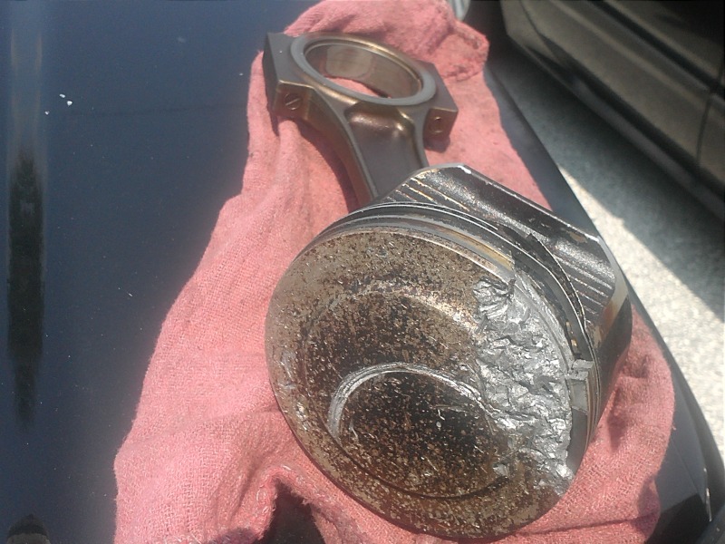

Well....I had a gut feeling that lower octane was the culprit there, somewhere amongst this mess along with bad detonation.

Well I believe you're on track, the water actually is an oxygenator, and the steam can dramatically increase compression, remember water injection of years gone by. I think the owner is now on the hook for a set of heads, and a total rebuild. Might be better to see if you can round up a crate engine----time,labor, warranty.

Wow, haven't seen a hole like that before. I don't see the water/coolant reducing the octane of the fuel. http://en.wikipedia.org/wiki/Water_injection_(engines) Water injection has been used for decades to delay or prevent detonation in ICEs (internal combustion engines). However, I agree there was detonation happening, as I don't see the pieces above the top piston ring coming out by themselves. The piston top looks like the pieces were bouncing around for a while, if I didn't know better. Kind of reminds me of a bead-blasted surface.
How many miles on the engine? Is the head warp enough to cause a head gasket leak? What do the other pistons and plugs look like? Anyone think a poorly setup N2O setup might cause the lean condition for the detonation? A leaking runner for that cylinder might be a culprit also, since the O2 sensor is on the entire bank, and not by cylinder...
Curious to see what the warranty folks say.

Seen similar but NEVER that bad.
I agree completely with the lean state theory - and I also agree that the owner was operating a vehicle that was running like poo-poo with an unmistakable CEL for quite some time.
Coolant into the cylinder would be my first guess...

Ehhhhh not so true.... Water Injection is only effective when the solution that is being injected has been atomized by an injector type device.
When your head gasket leaks into a cylinder it effectively reduces compression, and as a result makes the fuel less reactive under the compression cycle of the Piston.
So yes true that it will have little to no affect on the octane rating, but incorrect that it would act in a similar manner to an Alcohol/Methanol/Water Injection System....

I think you have enough information posted to finish your tear-down of the engine and see what the Warranty Company says, My bet is they will deny it based upon the head gasket failure (depending on mileage)... But who knows for sure what they will say.
I can say however that this customer will pretty much need an entire new engine (with heads), and injectors... just about the only thing that can be reused is the fuel rails (possibly) and the accessories (PS, A/C Compressor, & Alternator).
Going to be an expensive day to say the least.
