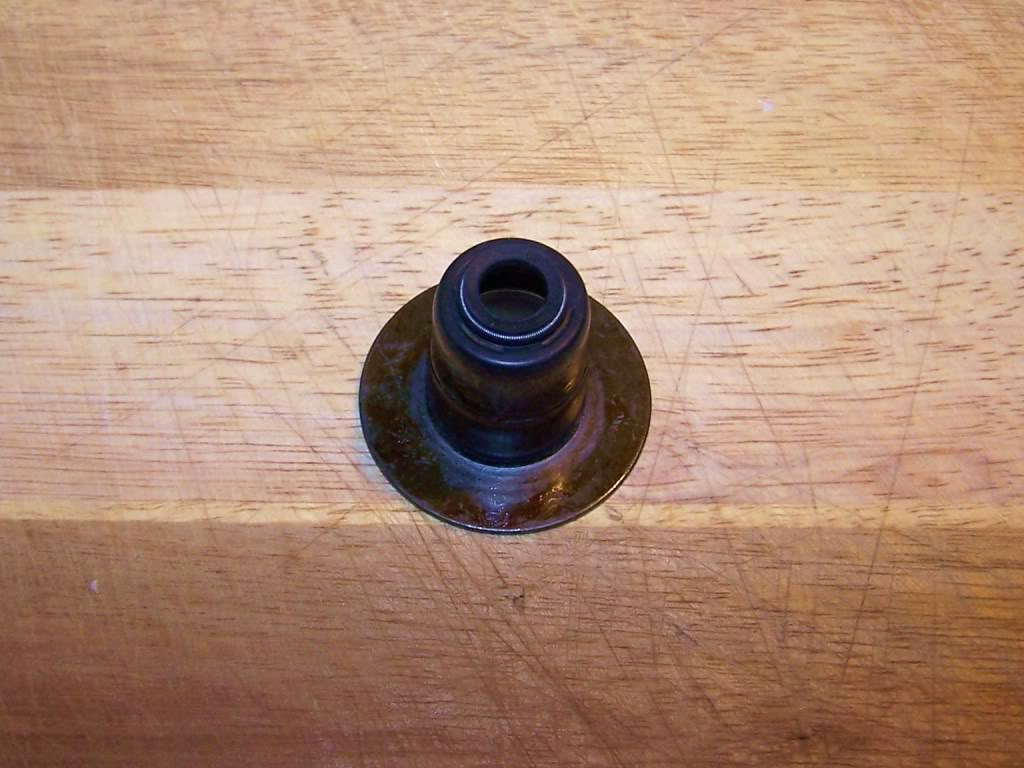

looks like the spring from the valve seal
Looks pretty odd from that picture.. but anything is possible.

The valve seal spring is exactly what it is
