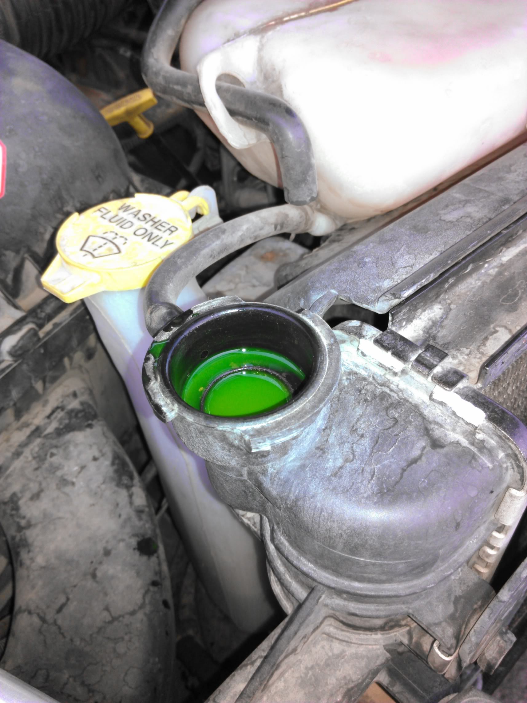

Hey, I dont really want to hi-jack this thread, But i think it pertains to almost the same information sorta. I just bought my truck last month. the previous owner seem to take good care of the truck (changed oils, diff fluids, tranny fluids, rebuilt tranny with upgraded parts) however, I check the antifreeze and i know on the dodge rams you are suppose to use a special kind (even says it on the overflow cap).
well from what you guys have been posting and what I have, did the previous owner screw up and do i need to do a antifreeze flush? mine is green, not red.

Do you have a 5.9 or 4.7 V8?
If 5.9, you can leave it. If 4.7 flush it out.

yea i have a 5.9, thanks for the info. However, although the radiator is full, the reservoir is low. what should i fill it with?

Get you some standard green and mix it 50/50 in a bottle with distilled water. Pour it on in.
