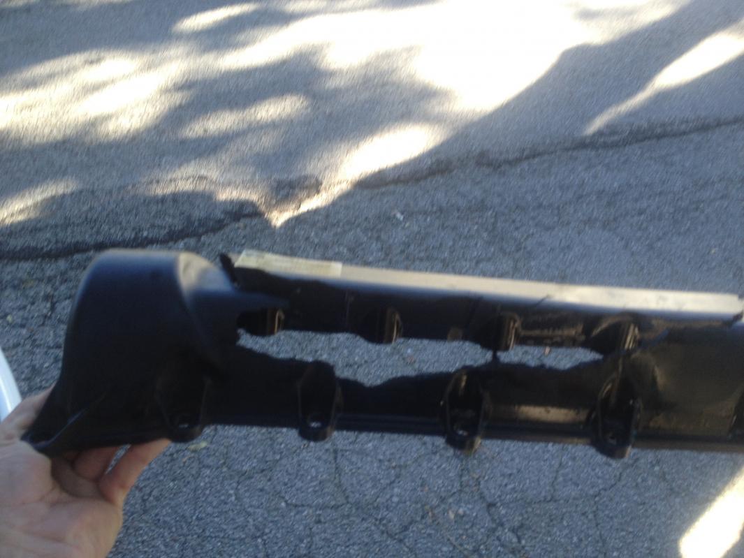

Pull the valve cover off today. I don't see any damage to the valve train pulled plugs out and don't see wrong

Check the pcv valve, make sure its working ok, may have drained some fuel past the rings and detonated it.
