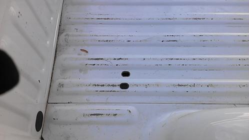

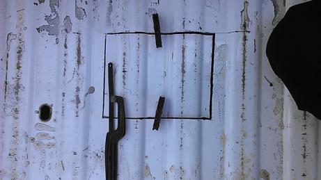

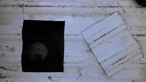

Operation - look under the truck to get your bearings. I used a tape measure and a plastic drain plug in the bed to get my measurements and location right. Its not difficult and takes maybe ten minutes to draw your lines. I went with a 7 x 9" hole so I had some room to move in there and it was damn near perfect. I kind of got a little lucky with the placement and size. The pump is not dead center, its more to the top of the hole and to the left. Had it been centered i think getting the ring off (read further) might have been more difficult. To cut the hole I used an electric grinder with a 4 1/2" metal cutting disc. Start to finish about 20-25 minutes. The pump is secured by a metal ring, soak it was pretty rusty so I soaked it in pb blaster overnight. Thoroughly clean the area with a scrub brush before proceeding. Seriously, make it spotless. You do not want dirt and debris falling into the tank during this, especially if you didn't or don't plan on draining the tank. Get dirt in the there and your screwed. Moving on, I then used a hefty flat blade screw driver and hammer to drive the ring loose. It was difficult and I thought it wasn't going to give but I kept at it and eventually it came loose. I should mention I had a quarter tank of gas in there. The less gas the better but I did not drain the tank. To remove the old pump you have to twist it around a bit and convince it a little. There's a cup at the base of the pump that was hung up on the lip of the tank but I used a screw driver to massage it out. Be careful not to chip, snap, or break off any plastic lest it falls into the tank. The new pump goes in the same way the old came out. Plug in your wiring harness, attach the fuel line and that's it. She should fire right up. This process was 30 minutes tops and with cutting the hole, your all in with about an hour on the clock of actual work. I did spend considerably more time planning, agonizing and talking myself into it, I ain't going to lie to you. I know how to weld so repairing the hole was not the issue so much as just the idea of cutting it in the first place. Yea my truck is almost ten years old with a ton of miles but she's pretty damn close to cherry. It wasn't easy to put her under the knife but I'm damn glad I did. Hell, If Chrysler engineers had a brain cell among them, there'd be an access plate there from the factory.
Ok so now you have a hole in the bed of your truck. What to do. Even though I could weld the cut out back in no problem, I'm not going to. The quickest and easiest way to go with this is ask your local junk yard to cut out a piece of floor larger than the hole from a junker they have out in the yard. Drill some holes, counter sink some sheet metal screws and maybe squeeze some gasket maker in around the hole to seal it and prevent rust. My local you-pull-it said no problem when I called. You might also be able to score a patch panel and make your access plate out of that, I haven't looked into that though. Side note, I know I said I wasn't going to weld the cut out back in, and I'm not, but what I might try doing is welding a flange around the outside edges of the cutout to make my access plate, just as excuse to fill my Oxy A tanks and get some practice in.
