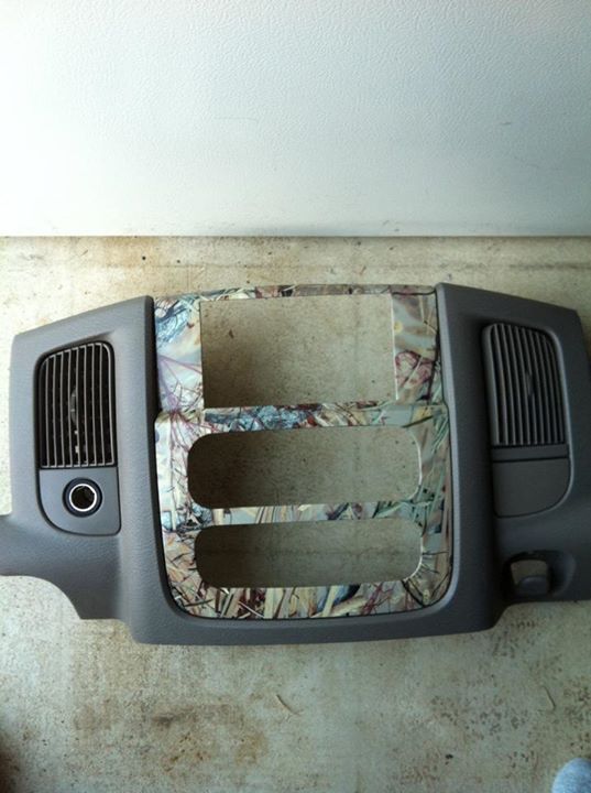

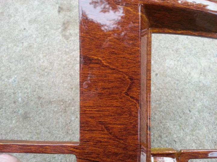

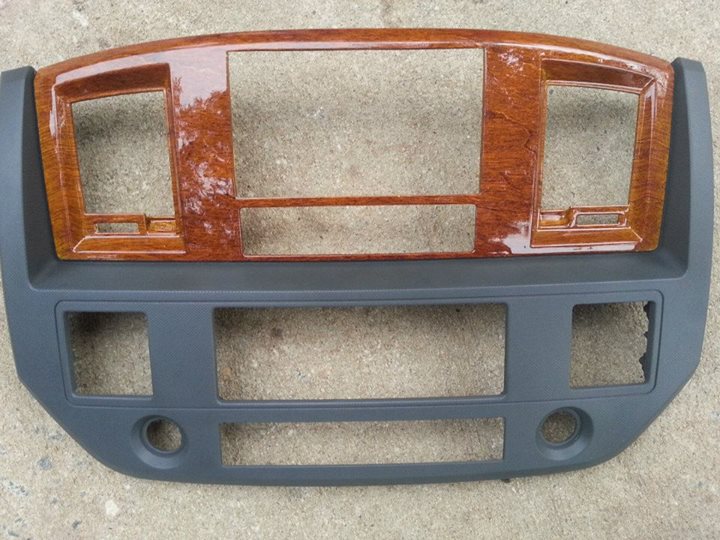

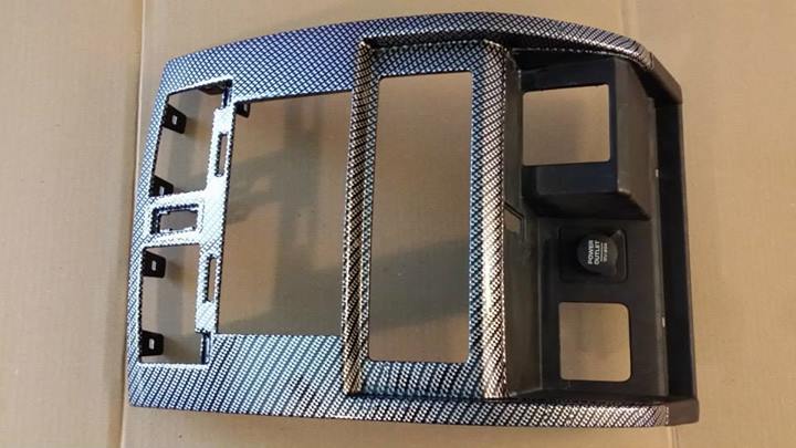

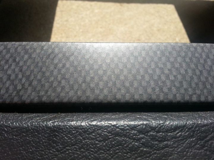

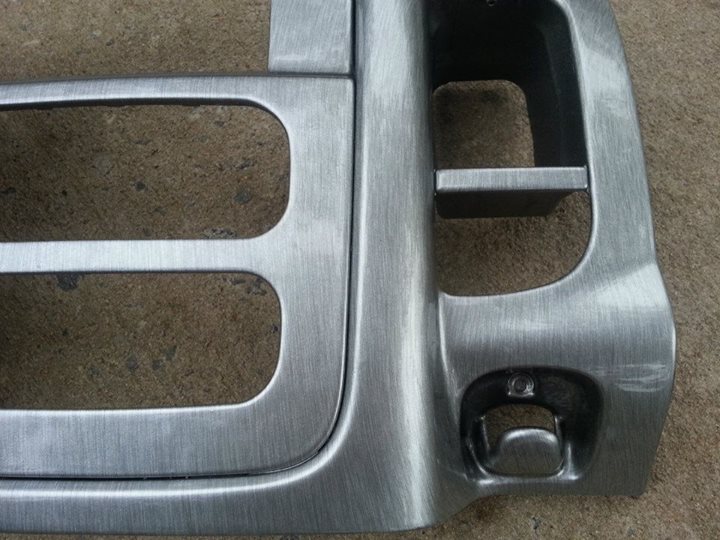

Here are some pics of pieces I have done but I am using professional tanks, professional Satajet 3000 and 4000 guns, automotive grade base coats and clears, ect

I like that sliver brushed looking one just below the woodgrain. How durable is that stuff? You clear right over it?
I ask this because the OEM bezel is wearing where I rest my palm on to change settings on the radio.
Is that stuff UV and/or weather resistant? I plan on regularly pressure washing my dash..haha

That wood looks incredible. Got an example of any burlwood pieces you've done, weed?

Dirty, I get that question a lot on how durable it is. I use automotive grade urethane based base costs and 2K primer. No rattle can crap

Prismatic, I do a lot of burns for the calibers and early 3rd Gen Rams. The 06-08 there is no an exact pattern or print available to the consumer as they still use that print in their Mercedes
