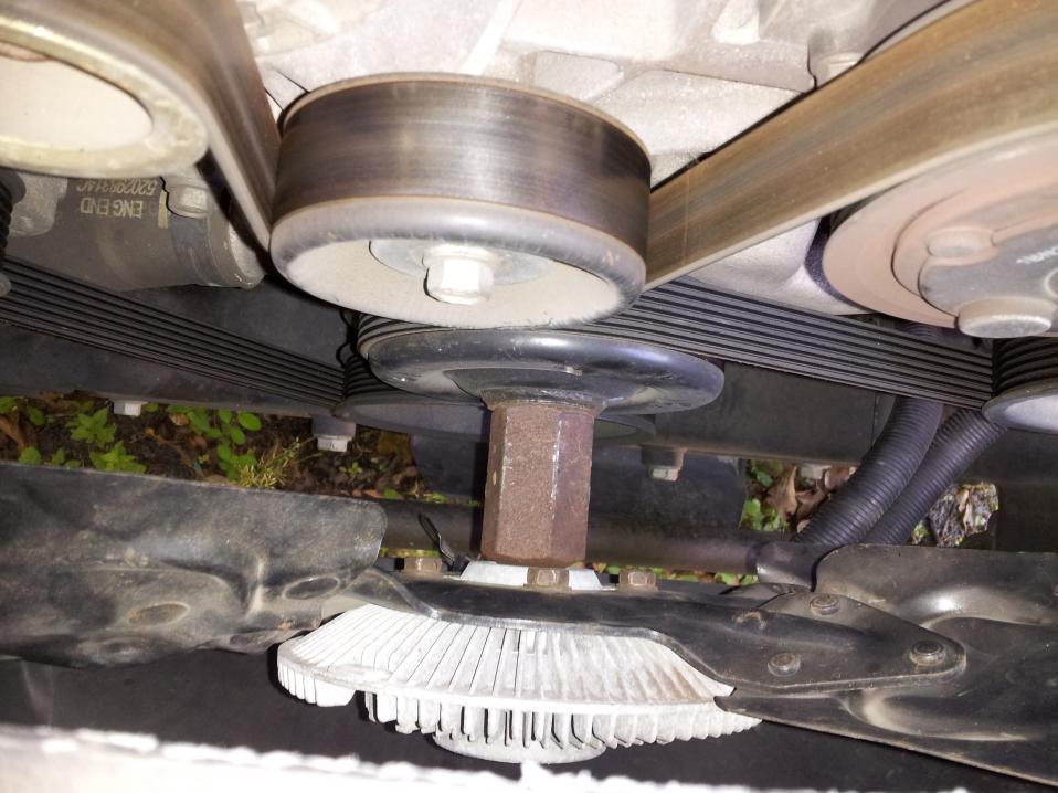

Anyone know the part number for the correct fan clutch? I bought one and paid to have it installed but its the wrong one, the nut it too short. The stock nut is longer and puts the fan in the shroud, the replacement keeps the fan outside of the shroud. Checked 3 stores and also the store I had working on the truck (RPM) and all they had was clutches with the short nut.
Part I bought was #922790. (autozone)

Mike, the part at RockAuto looks about the same as what RPM sold. It was a little closer to the shroud but not much more than what I got at Autozone. The nut on the stock clutch is 2.25" long.

Here's a picture of the fan clutch so you can see how long it is.
