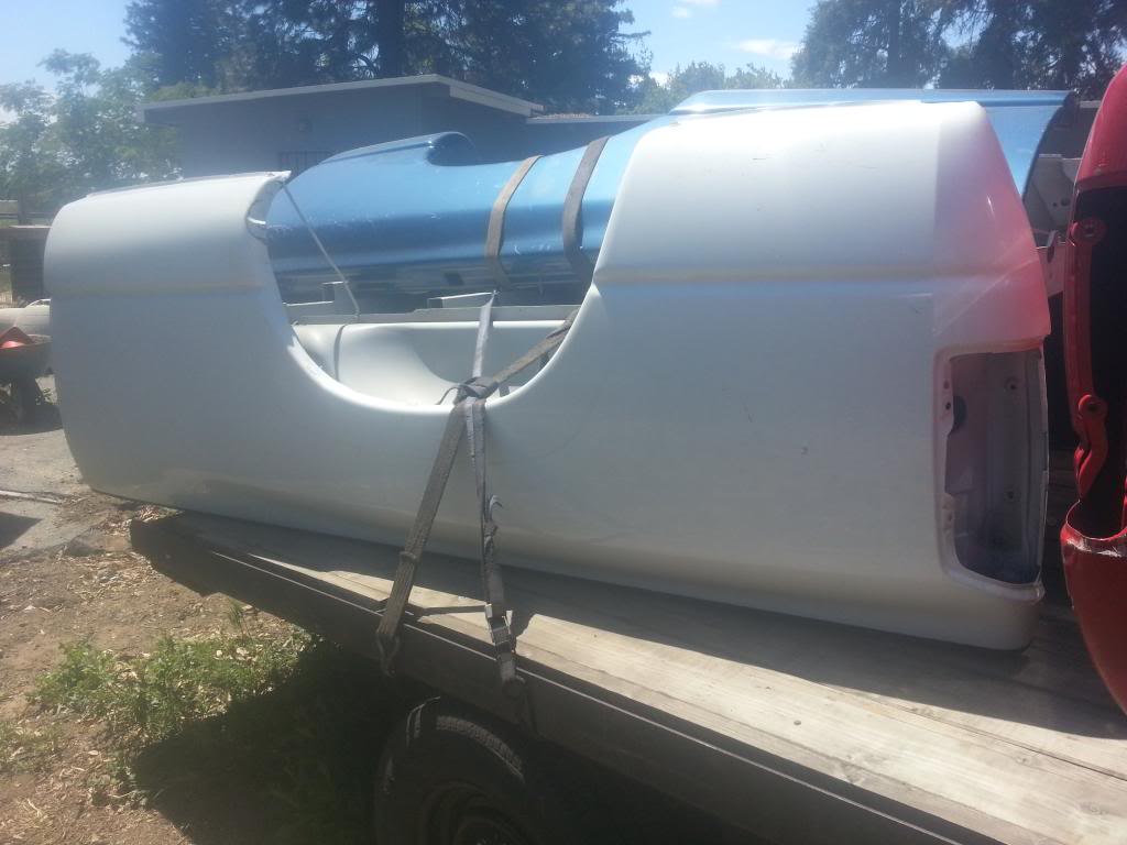

new bed

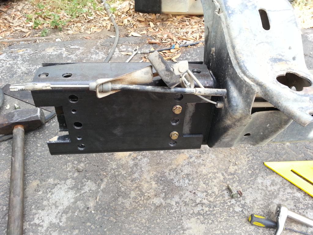

my spacers i built
one instaled on QCLB frame (welding after its all together)

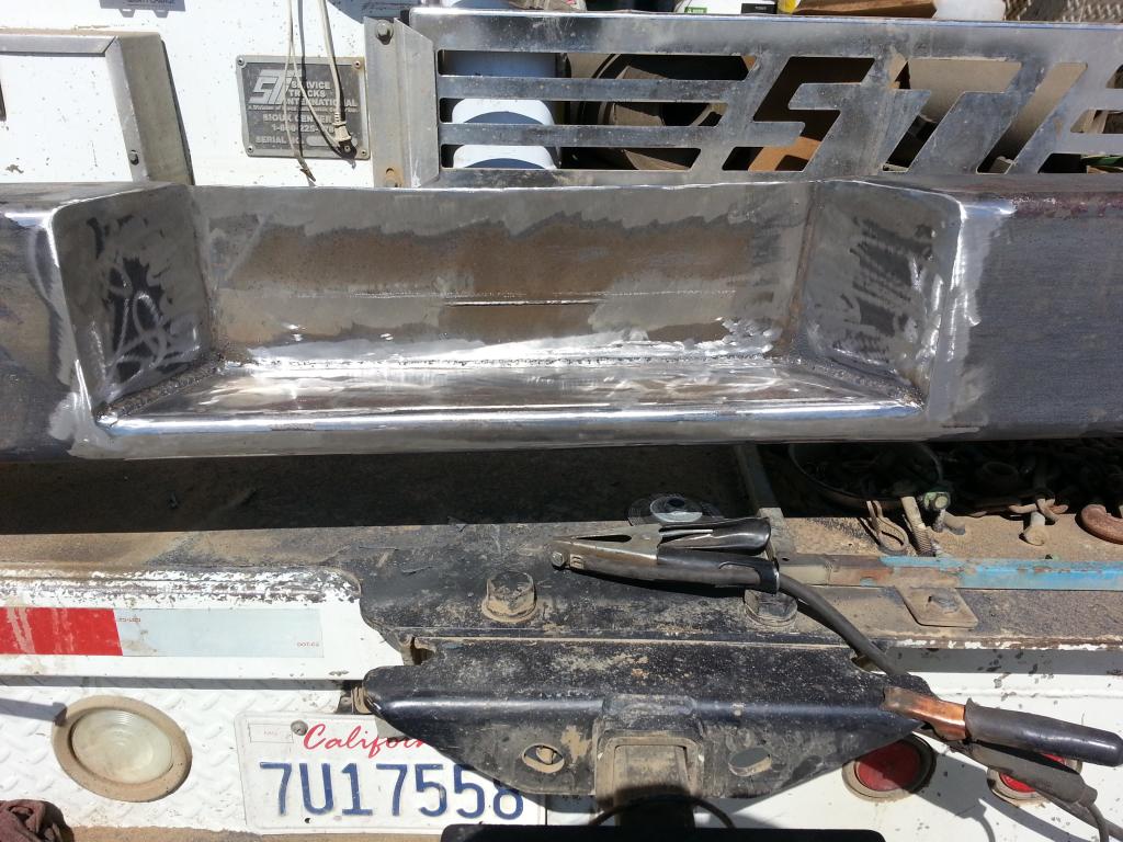

and the bumper in progress

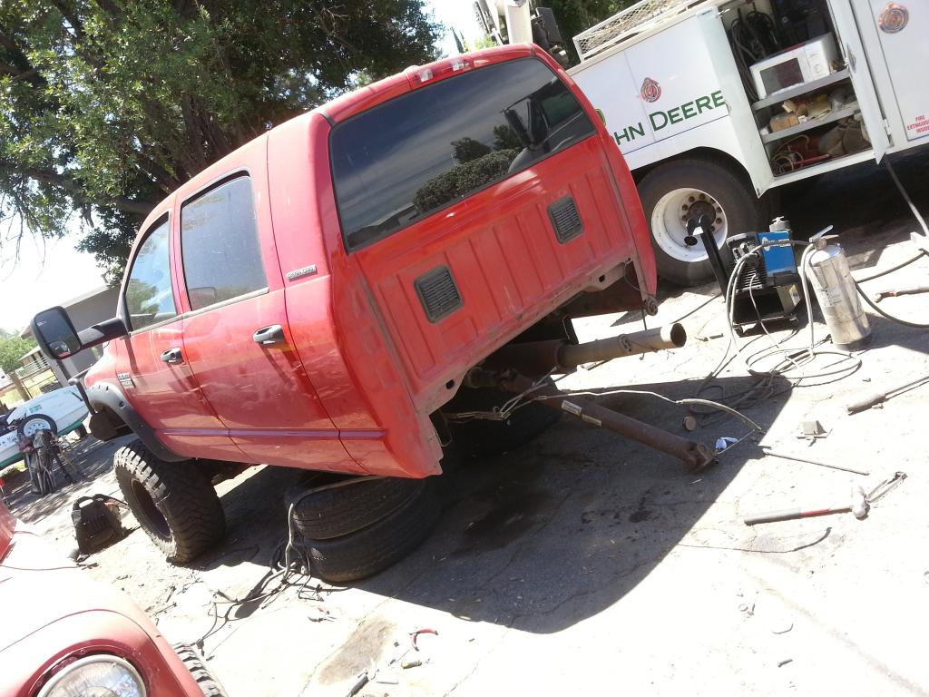

sorry its taken me a bit, its been very busy around here but here is what i have gotten done in the last few days
stripping down
and cut it off... pretty sad site

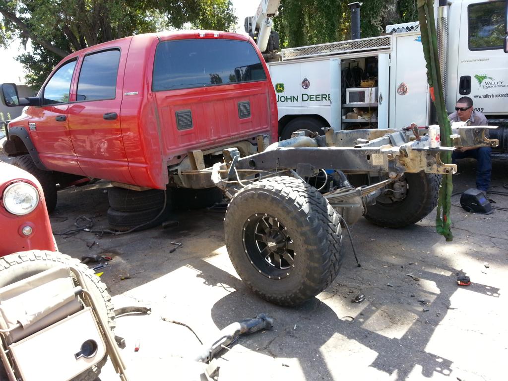

new frame back on
new bed set on there

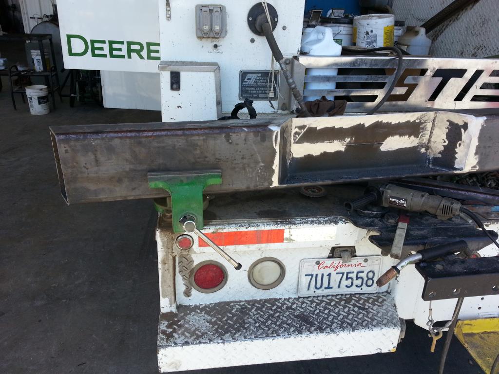

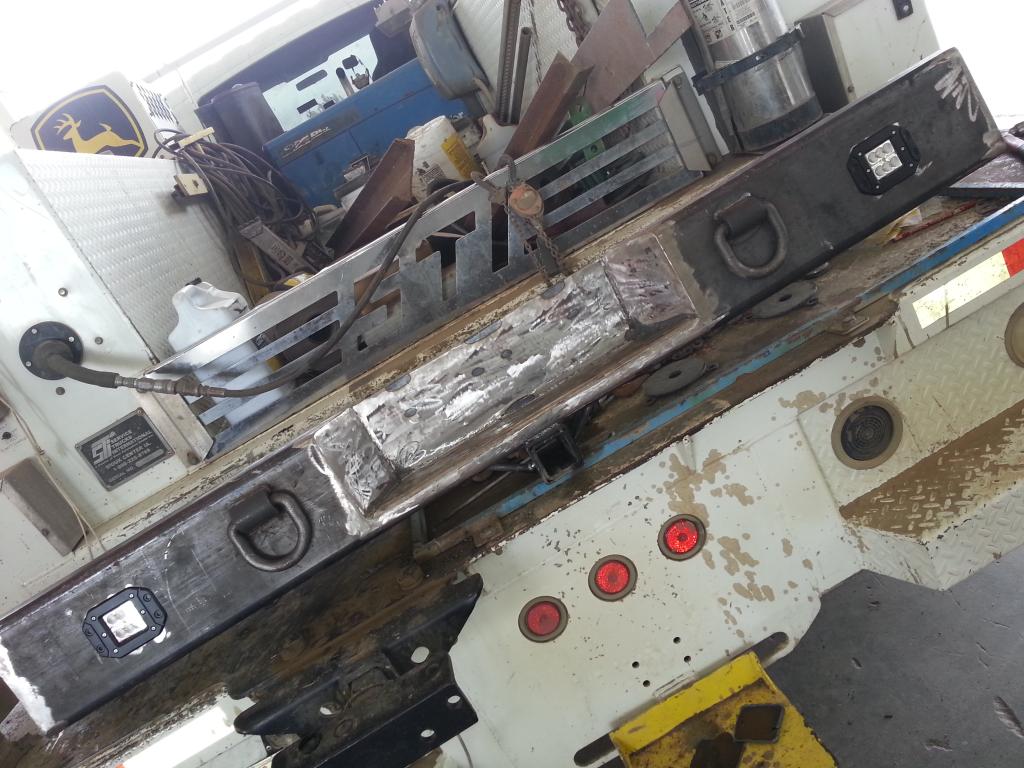

and some more bumper work
still have to weld the frame, been taking my time with the alignment because i want it perfect, then its a matter of paint and line-x for the bumper, and reassemble everything
