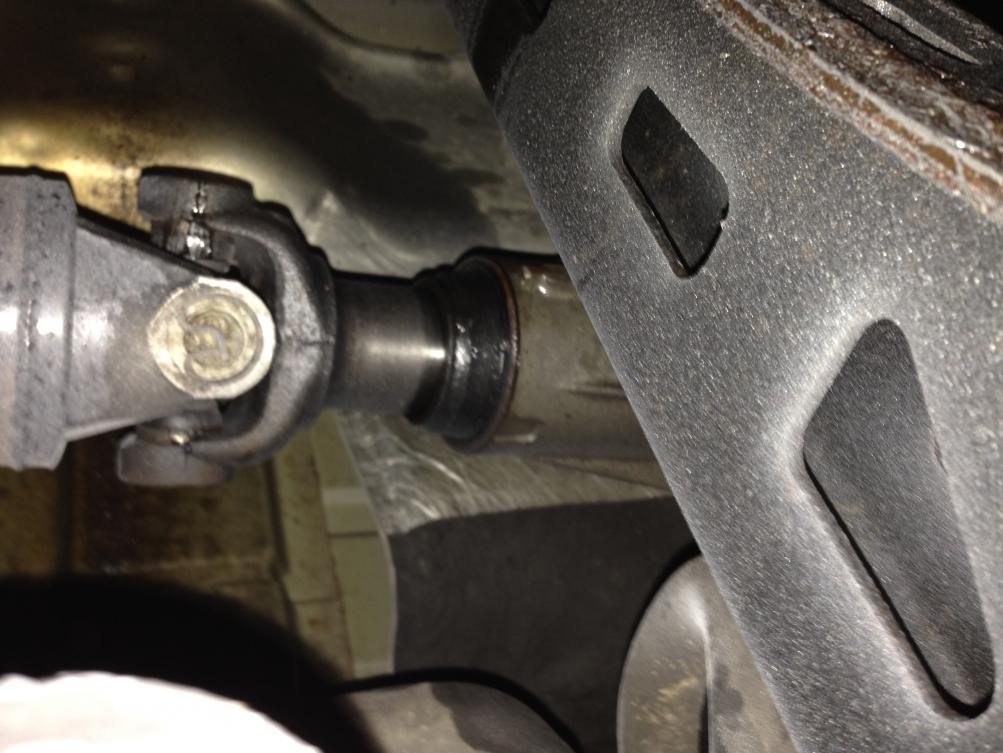

Thanks for the help. I got a new seal from O'reilly, but the one on my truck currently has a boot attached to the seal and the new seal does not have a boot. Guy from O'reily says that they don't stock the one with the boot and that it "probably doesn't matter" …..I hate when they say that
Again, this is the tail output seal coming out of the back of the transfer case.
Anybody know? The one he sold me is National part #3946
Thanks!

Nevermind, it was the wrong seal. For the record the correct seal is o'relly Part # 710660 and Mopar part #5019026AA and it is called the Transfer Case Output Shaft Seal "REAR". This is why I always work on this truck myself and always seek advice on this forum. Nobody else who works on or sells you parts cares about your truck as much as you do Hope this helps someone out! Please correct me if you think anything here is wrong so we can all learn more.
