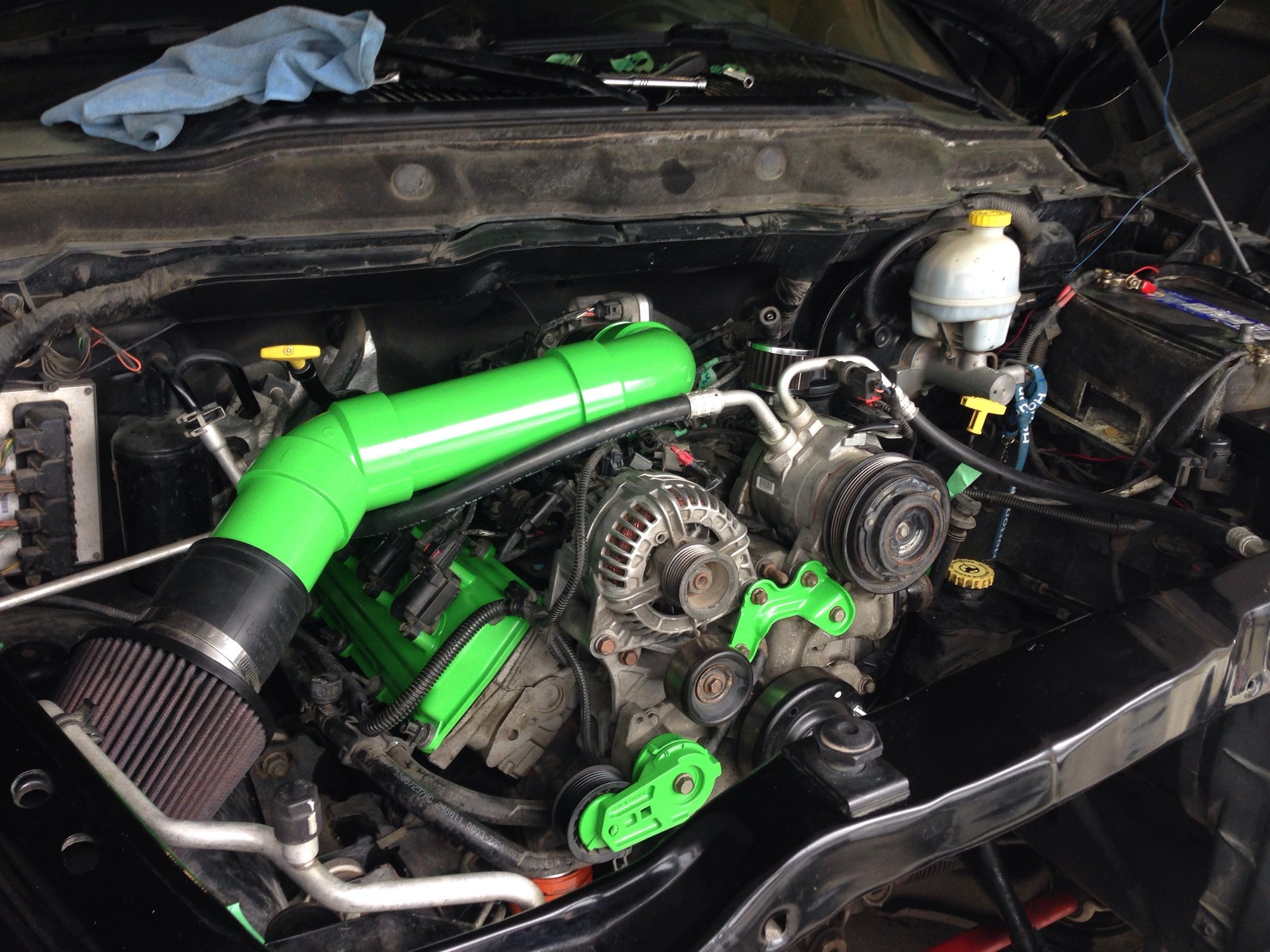

Just thought I would share my findings with you guys:
I have a 2003 half ton with a 5.7 that I dropped in a comp 260 cam. Has longtube headers, tuned on super chips 91 (for now), and I had a homemade CAI as many have made in this forum. Gains from the cam weren't very impressive to say the least, I had lost a lot of lowend which was surprising to me. Anyways my A/C gave out so I decided to delete it and route a true cold air and ram air intake to the front of the grill, a homemade vararam if you will. All I can say is WOW! My motor must not have liked the smaller filter and hot air from the previous setup... I went with a larger filter and it's seeing a lot colder air now and the gains are incredible...
I had run a 15.7 on the 1/4 mile post cam install with the old intake setup. I would be willing to bet it will hit high 14s now. The intake feels like it was a HUGE bottleneck. I will post back with updated times this weekend. Just food for thought for you guys with homemade setups sucking hot engine bay air.

Very nice man. I like that set up! Valve covers look sick
