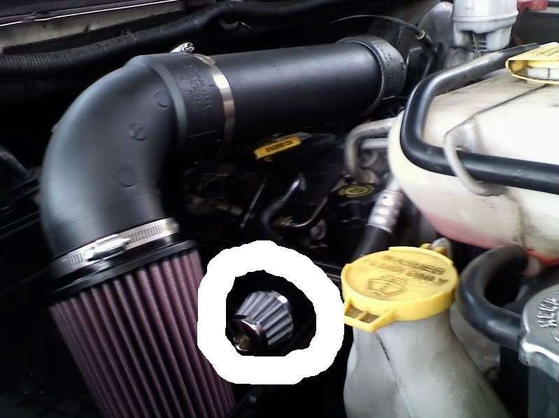

No clue, like I said the '03 was the first year of the Hemi Ram and it's a red headed step child.
Here is a CAI I made for an old member with an '04 and if you look at the circle you'll see I rerouted the PCV to collect in that small filter instead of leaving gunk in the engine. You'll note the metal tube that P23851 was referring to that the '03 doesn't have.
