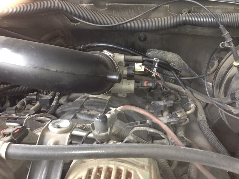

I would check the IAC.

Is this idle air control part of the throttle body? Can it be cleaned or whole new throttle body?

connector w
ed tab center of photo
hope this helps
